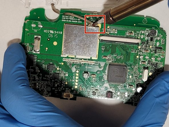

  8. Infant Optics DXR-8 Monitor Motherboard Replacement, Monitor Motherboard: crwdns2935265:08crwdnd2935265:01crwdnd2935265:02crwdne2935265:0 Infant Optics DXR-8 Monitor Motherboard Replacement, Monitor Motherboard: crwdns2935265:08crwdnd2935265:02crwdnd2935265:02crwdne2935265:0
    • Flip the motherboard away from the case.
    • Using a soldering iron and desoldering braid, desolder the antenna from the motherboard.
    • For more information on soldering, please visit the How to Solder and Desolder Connections guide.
