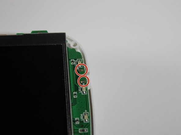

    • Using the plastic opening tool, remove screen protector from front of monitor.
  2. Infant Optics DXR-8 Charging Port Replacement: crwdns2935265:02crwdnd2935265:01crwdnd2935265:03crwdne2935265:0 Infant Optics DXR-8 Charging Port Replacement: crwdns2935265:02crwdnd2935265:02crwdnd2935265:03crwdne2935265:0 Infant Optics DXR-8 Charging Port Replacement: crwdns2935265:02crwdnd2935265:03crwdnd2935265:03crwdne2935265:0
    • Remove the six 4mm screws using a Phillips #00 screwdriver.
    • Remove the screen, exposing the circuit board.
    • Turn device over to expose rear circuit board.
  3. Infant Optics DXR-8 Charging Port Replacement: crwdns2935265:03crwdnd2935265:01crwdnd2935265:03crwdne2935265:0 Infant Optics DXR-8 Charging Port Replacement: crwdns2935265:03crwdnd2935265:02crwdnd2935265:03crwdne2935265:0 Infant Optics DXR-8 Charging Port Replacement: crwdns2935265:03crwdnd2935265:03crwdnd2935265:03crwdne2935265:0
    • Disconnect speaker from monitor for ease of access by unplugging wire.
  4. Infant Optics DXR-8 Charging Port Replacement, Charging Port: crwdns2935265:04crwdnd2935265:01crwdnd2935265:02crwdne2935265:0 Infant Optics DXR-8 Charging Port Replacement, Charging Port: crwdns2935265:04crwdnd2935265:02crwdnd2935265:02crwdne2935265:0
    • Unscrew the four 3 mm screws holding the motherboard to the unit using a Phillips #00 screwdriver.
  5. Infant Optics DXR-8 Charging Port Replacement: crwdns2935265:05crwdnd2935265:01crwdnd2935265:02crwdne2935265:0 Infant Optics DXR-8 Charging Port Replacement: crwdns2935265:05crwdnd2935265:02crwdnd2935265:02crwdne2935265:0
  6. Infant Optics DXR-8 Charging Port Replacement: crwdns2935265:06crwdnd2935265:01crwdnd2935265:01crwdne2935265:0
    • Remove the old charging port and solder the new one in place.
    • After removing the old port make sure to clean ALL the excess solder from the though holes.
    • Add a little solder to each of the 5 surface mount pads on the PCB before putting the new port on. Its a bit of a tight fit between the screen and the port so getting an iron and solder positioned correctly without blobbing or bridging is hard.
    • Place the new port on and make sure the large pins fit though the holes (the won't go all the way though)
    • Solder one of the though holes to start (if you mess up the surface pads its easier to get back off if you only have to melt one structural connection)
    • Solder the 5 surface mount pads. If the port didn't sit all the way down to the PCB you can push each pin down with the iron onto the pad and into the solder. (pre adding solder to those pads helps with this)
    • Finishing soldering the though hole pins.
  7. Infant Optics DXR-8 Charging Port Replacement: crwdns2935265:07crwdnd2935265:01crwdnd2935265:01crwdne2935265:0
    • Flip the unit over to ensure a correct fitment.
