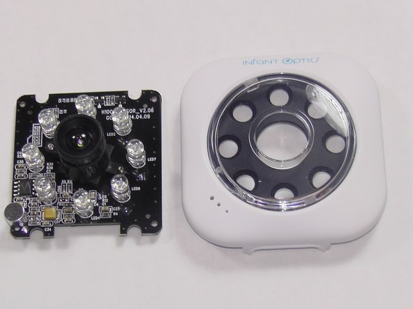

    • Using a Phillips #2 screwdriver, remove the four, 6.0 mm Phillips screws from the back of the camera unit.
  2. Infant Optics DXR-5 Camera Replacement: crwdns2935265:02crwdnd2935265:01crwdnd2935265:02crwdne2935265:0 Infant Optics DXR-5 Camera Replacement: crwdns2935265:02crwdnd2935265:02crwdnd2935265:02crwdne2935265:0
    • Pull up on the two beige tabs to the left and right of the ribbon connected to the camera.
    • Pull the ribbon straight out from the camera.
  3. Infant Optics DXR-5 Camera Replacement: crwdns2935265:03crwdnd2935265:01crwdnd2935265:02crwdne2935265:0 Infant Optics DXR-5 Camera Replacement: crwdns2935265:03crwdnd2935265:02crwdnd2935265:02crwdne2935265:0
    • Remove the front face plate of the camera unit by carefully pulling it off.
