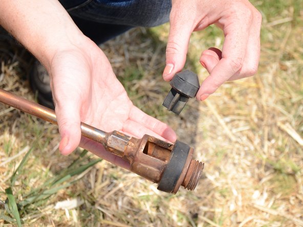

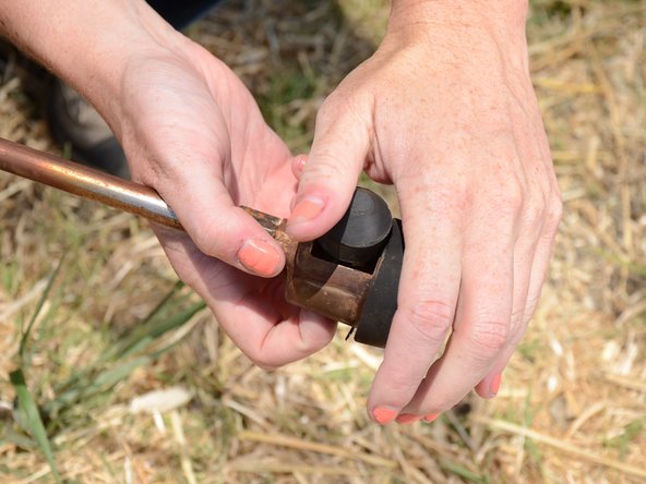

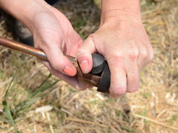

  43. India Mark III Traveling Valve Replacement, Traveling Valve: crwdns2935265:043crwdnd2935265:01crwdnd2935265:03crwdne2935265:0 India Mark III Traveling Valve Replacement, Traveling Valve: crwdns2935265:043crwdnd2935265:02crwdnd2935265:03crwdne2935265:0 India Mark III Traveling Valve Replacement, Traveling Valve: crwdns2935265:043crwdnd2935265:03crwdnd2935265:03crwdne2935265:0
    • Use a finger to push the rubber valve poppet out of the traveling valve.
  44. India Mark III Traveling Valve Replacement: crwdns2935265:044crwdnd2935265:01crwdnd2935265:02crwdne2935265:0 India Mark III Traveling Valve Replacement: crwdns2935265:044crwdnd2935265:02crwdnd2935265:02crwdne2935265:0
    • Remove the poppet from the traveling valve.
    • Check for signs of wear or damage.
