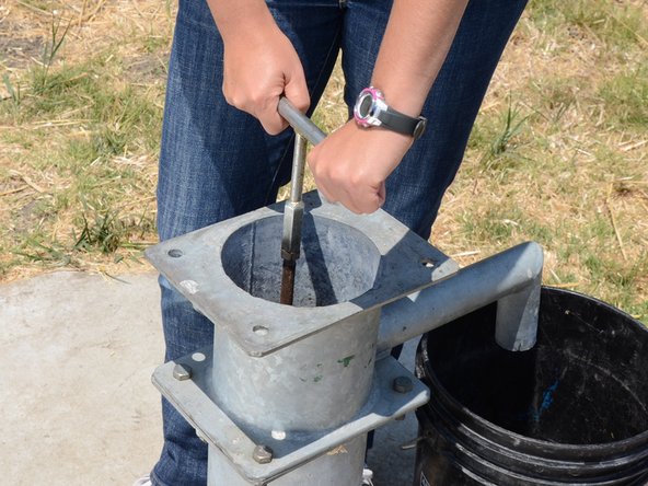

  26. India Mark III Foot Valve Replacement: crwdns2935265:026crwdnd2935265:01crwdnd2935265:03crwdne2935265:0 India Mark III Foot Valve Replacement: crwdns2935265:026crwdnd2935265:02crwdnd2935265:03crwdne2935265:0 India Mark III Foot Valve Replacement: crwdns2935265:026crwdnd2935265:03crwdnd2935265:03crwdne2935265:0
    • Screw a T-handle onto the top of the pump rod. Tighten the T-handle against the jam nut.
  27. India Mark III Foot Valve Replacement: crwdns2935265:027crwdnd2935265:01crwdnd2935265:02crwdne2935265:0 India Mark III Foot Valve Replacement: crwdns2935265:027crwdnd2935265:02crwdnd2935265:02crwdne2935265:0
    • Have one team member lightly pull up on the T-handle, while another loosens the rod clamp. This will prevent damage to the pump.
  28. India Mark III Foot Valve Replacement: crwdns2935265:028crwdnd2935265:01crwdnd2935265:03crwdne2935265:0 India Mark III Foot Valve Replacement: crwdns2935265:028crwdnd2935265:02crwdnd2935265:03crwdne2935265:0 India Mark III Foot Valve Replacement: crwdns2935265:028crwdnd2935265:03crwdnd2935265:03crwdne2935265:0
    • Remove the rod clamp from the tank.
  29. India Mark III Foot Valve Replacement: crwdns2935265:029crwdnd2935265:01crwdnd2935265:02crwdne2935265:0 India Mark III Foot Valve Replacement: crwdns2935265:029crwdnd2935265:02crwdnd2935265:02crwdne2935265:0
    • Use the T-handle to rotate the entire pump rod clockwise several full turns.
    • The foot valve is threaded and will screw into the base of the traveling valve, allowing you to pull the two valves up out of the well together.
    • Keep turning until the resistance greatly increases. The foot valve will provide this resistance when fully screwed into the traveling valve base.
