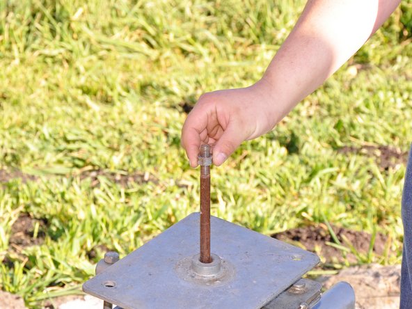

    • Use a wrench to remove the bolt on the top of the cover plate.
    • When replacing the cover plate, this bolt only needs to be hand tight.

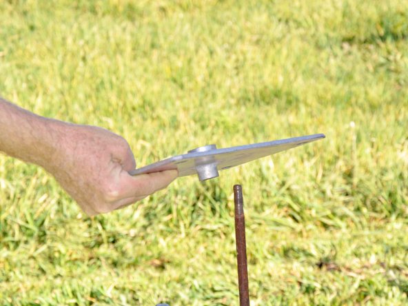

  2. India Mark II Pump Cylinder Replacement: crwdns2935265:02crwdnd2935265:01crwdnd2935265:01crwdne2935265:0
    • Remove the top cover by pulling it straight off the pump.
    • Store the top cover in a sanitary place, preferably above ground, to prevent contamination.

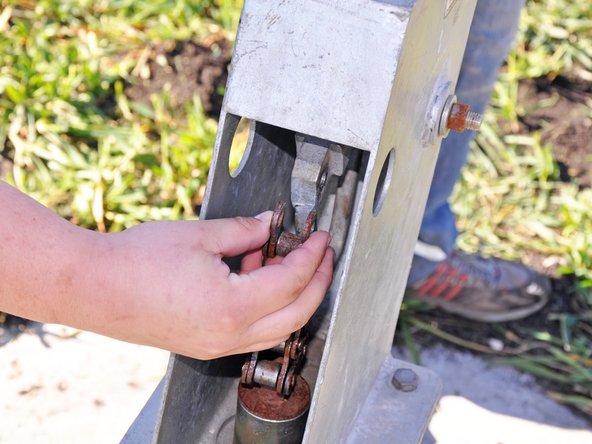

  4. India Mark II Pump Cylinder Replacement: crwdns2935265:04crwdnd2935265:01crwdnd2935265:02crwdne2935265:0 India Mark II Pump Cylinder Replacement: crwdns2935265:04crwdnd2935265:02crwdnd2935265:02crwdne2935265:0
    • Remove the bolt connecting the chain to the pump handle.
    • Remove the chain from the handle.

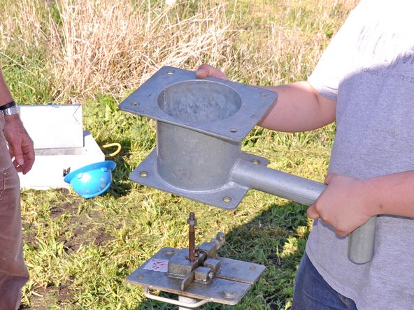

    • There are 4 bolts securing the head section to the water tank, located at the corners of head section base.
    • Continue supporting the pump handle so the pump head doesn't fall off when all the bolts are removed.
    • Remove the 4 bolts on the base of the water tank.
  6. India Mark II Pump Cylinder Replacement: crwdns2935265:06crwdnd2935265:01crwdnd2935265:01crwdne2935265:0
    • Lift the pump head off of the water tank and place in a sanitary place, preferably above ground, to prevent contamination.

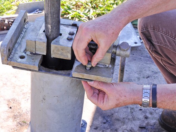

  7. India Mark II Pump Cylinder Replacement, Water Tank: crwdns2935265:07crwdnd2935265:01crwdnd2935265:03crwdne2935265:0 India Mark II Pump Cylinder Replacement, Water Tank: crwdns2935265:07crwdnd2935265:02crwdnd2935265:03crwdne2935265:0 India Mark II Pump Cylinder Replacement, Water Tank: crwdns2935265:07crwdnd2935265:03crwdnd2935265:03crwdne2935265:0
    • Lift the plunger assembly and separator plate and place a rod clamp below the separator plate.
    • Tighten the rod clamp and gently set the separator plate on top of it.
    • Remove the spacer.

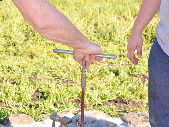

  10. India Mark II Pump Cylinder Replacement: crwdns2935265:010crwdnd2935265:01crwdnd2935265:02crwdne2935265:0 India Mark II Pump Cylinder Replacement: crwdns2935265:010crwdnd2935265:02crwdnd2935265:02crwdne2935265:0
    • Lift up on the T-handle to take pressure off the rod clamp.
    • Remove the rod clamp and slowly lower the T-handle.
    • The pump rod will rest on the end cap, located below the cylinder of the pump. It is important to lower the T-handle slowly to prevent damage to the pump.

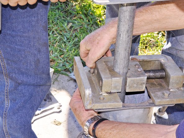

  13. India Mark II Pump Cylinder Replacement: crwdns2935265:013crwdnd2935265:01crwdnd2935265:02crwdne2935265:0 India Mark II Pump Cylinder Replacement: crwdns2935265:013crwdnd2935265:02crwdnd2935265:02crwdne2935265:0
    • Secure the base clamp to the pump base with two bolt and nut sets installed on opposite sides of each other.
    • Hand tight will be sufficient for securing the base clamp.
    • Use the nuts and bolts removed from the water tank base or head section base.

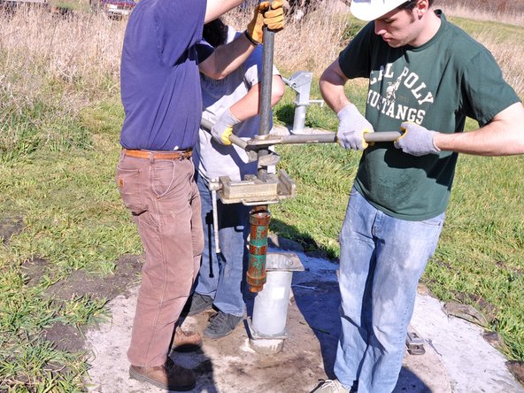

  18. India Mark II Pump Cylinder Replacement: crwdns2935265:018crwdnd2935265:01crwdnd2935265:03crwdne2935265:0 India Mark II Pump Cylinder Replacement: crwdns2935265:018crwdnd2935265:02crwdnd2935265:03crwdne2935265:0 India Mark II Pump Cylinder Replacement: crwdns2935265:018crwdnd2935265:03crwdnd2935265:03crwdne2935265:0
    • You will need at least three people to perform pipe lifting. Two people to lift, and one person to operate the base clamp. Workers should constantly be communicating whether they are ready, lifting, and whether or not the base clamp is secure.
    • Have two people place C wrenches on the riser main on opposite sides of each other.
    • C-wrenches should always be placed such that their openings are opposite and they do not contact each other, the base clamp, or the pipe coupling.
    • Have the two people with C-wrenches apply light upward pressure to the riser main while the base clamp operator loosens the clamp.
    • Lift the pipe evenly, not exceeding the comfortable lifting height of either lifter. Re-secure the base clamp once the maximum lifting height has been reached.
    • Lower the C-wrenches and repeat this step until the pipe coupling reaches the base clamp.

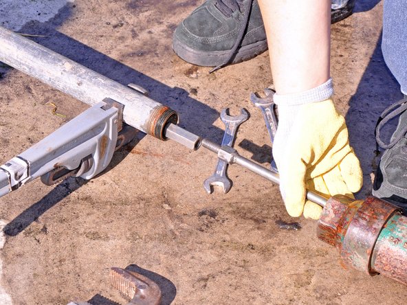

  21. India Mark II Pump Cylinder Replacement: crwdns2935265:021crwdnd2935265:01crwdnd2935265:03crwdne2935265:0 India Mark II Pump Cylinder Replacement: crwdns2935265:021crwdnd2935265:02crwdnd2935265:03crwdne2935265:0 India Mark II Pump Cylinder Replacement: crwdns2935265:021crwdnd2935265:03crwdnd2935265:03crwdne2935265:0
    • Lift and hold the upper pipe high enough to expose the pump rod coupling.
    • Place one open end wrench over the lower portion of the pump rod coupling. Hold this wrench steady.
    • Place another wrench on the upper portion of the pump rod coupling. Turn this wrench counterclockwise until the coupling separates.
    • Pull the upper pipe away from the pump and lay it on its side away from the pump.
    • Do not lay the pipe directly in grass or dirt, as you may get contaminants into the pipe that could obstruct water flow.

  23. India Mark II Pump Cylinder Replacement: crwdns2935265:023crwdnd2935265:01crwdnd2935265:03crwdne2935265:0 India Mark II Pump Cylinder Replacement: crwdns2935265:023crwdnd2935265:02crwdnd2935265:03crwdne2935265:0 India Mark II Pump Cylinder Replacement: crwdns2935265:023crwdnd2935265:03crwdnd2935265:03crwdne2935265:0
    • Loosen and remove the rod clamp.
    • Gently lower the T-handle.
    • Repeat steps 18 through 23 until you reach the pump cylinder.

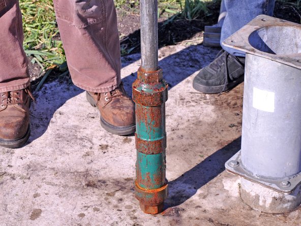

  24. India Mark II Pump Cylinder Replacement, Pump Cylinder: crwdns2935265:024crwdnd2935265:01crwdnd2935265:03crwdne2935265:0 India Mark II Pump Cylinder Replacement, Pump Cylinder: crwdns2935265:024crwdnd2935265:02crwdnd2935265:03crwdne2935265:0 India Mark II Pump Cylinder Replacement, Pump Cylinder: crwdns2935265:024crwdnd2935265:03crwdnd2935265:03crwdne2935265:0
    • When you reach the pump cylinder, lift the pipe so that the pump cylinder is just below the base clamp, but is not contacting it.
    • Secure the riser main with the base clamp.
    • Stabilize the pipe by holding it and unbolt the base clamp from the pump base.
    • Lift the riser main, pump cylinder, and base clamp straight up out of the well.
    • Set the cylinder down carefully to prevent damage, preferably on a clean surface.

    • Loosen and remove the base clamp.
    • Lay the pump cylinder on its side.

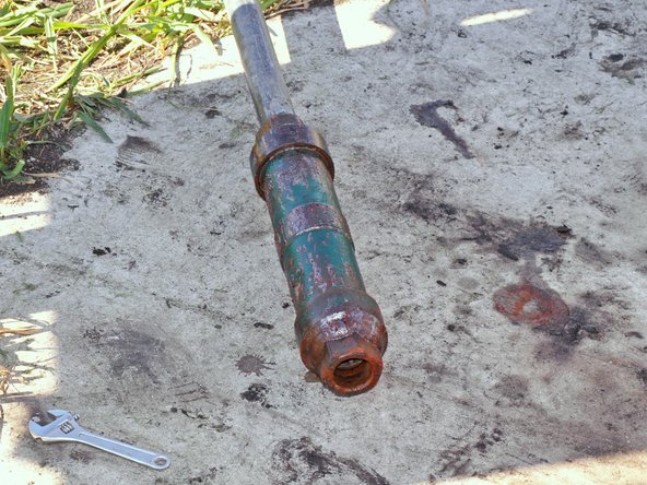

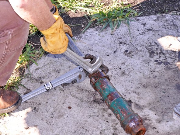

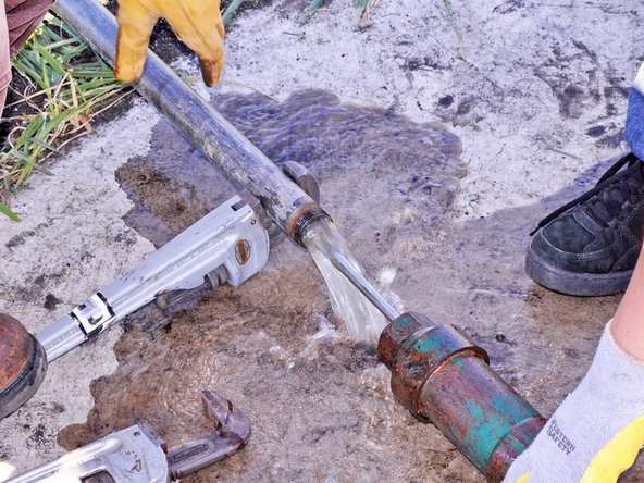

  26. India Mark II Pump Cylinder Replacement: crwdns2935265:026crwdnd2935265:01crwdnd2935265:03crwdne2935265:0 India Mark II Pump Cylinder Replacement: crwdns2935265:026crwdnd2935265:02crwdnd2935265:03crwdne2935265:0 India Mark II Pump Cylinder Replacement: crwdns2935265:026crwdnd2935265:03crwdnd2935265:03crwdne2935265:0
    • Use two pipe wrenches to separate the riser main and pump cylinder.
    • Separate the pump cylinder from the pipe.
    • The pump cylinder is still attached to the riser main via the pump rod.
  27. India Mark II Pump Cylinder Replacement: crwdns2935265:027crwdnd2935265:01crwdnd2935265:02crwdne2935265:0 India Mark II Pump Cylinder Replacement: crwdns2935265:027crwdnd2935265:02crwdnd2935265:02crwdne2935265:0
    • Slide the pump cylinder down far enough to expose the pump rod joint.
    • Separate the pump cylinder from the pipe and push rod using two crescent wrenches.
