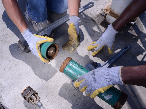

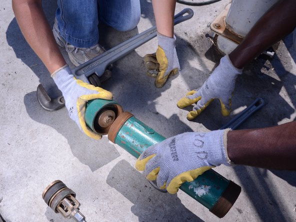

  50. India Mark II Foot Valve Replacement, Cylinder: crwdns2935265:050crwdnd2935265:01crwdnd2935265:01crwdne2935265:0
    • The last section of riser main pipe will have the pump cylinder attached to the bottom.
    • Pull the assembly of riser main pipe and cylinder out of the well and set the assembly on a block of wood to keep the cylinder off the ground.
  51. India Mark II Foot Valve Replacement: crwdns2935265:051crwdnd2935265:01crwdnd2935265:03crwdne2935265:0 India Mark II Foot Valve Replacement: crwdns2935265:051crwdnd2935265:02crwdnd2935265:03crwdne2935265:0 India Mark II Foot Valve Replacement: crwdns2935265:051crwdnd2935265:03crwdnd2935265:03crwdne2935265:0
    • Using two pipe wrenches, unscrew the cylinder from the riser main.
  52. India Mark II Foot Valve Replacement: crwdns2935265:052crwdnd2935265:01crwdnd2935265:02crwdne2935265:0 India Mark II Foot Valve Replacement: crwdns2935265:052crwdnd2935265:02crwdnd2935265:02crwdne2935265:0
    • Slowly pull the cylinder off of the pump rod, exposing the traveling valve and foot valve.

    • Using two pipe wrenches, remove the end cap from the cylinder.

    • Remove the foot valve from the end cap.
    • Take note of the direction of the foot valve in the end cap. This is extremely important for reassembly, as the pump will not work if the valve is facing the wrong direction.
