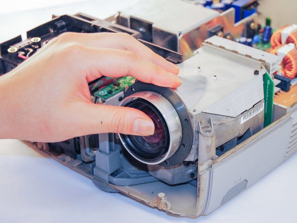

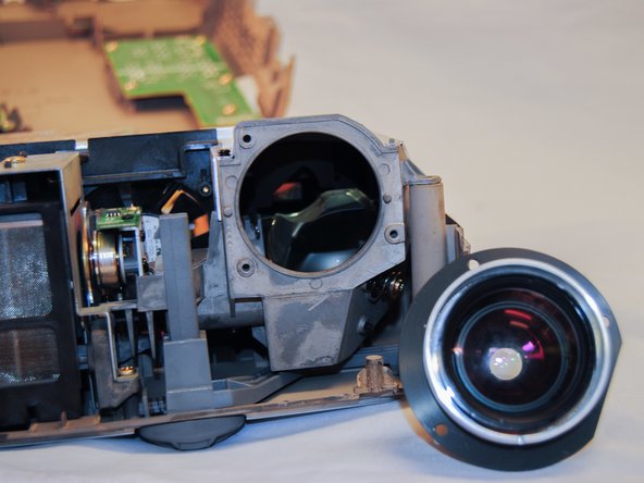

    1. InFocus Screenplay 4805 Lens Replacement, Lens: crwdns2935265:06crwdnd2935265:01crwdnd2935265:03crwdne2935265:0 InFocus Screenplay 4805 Lens Replacement, Lens: crwdns2935265:06crwdnd2935265:02crwdnd2935265:03crwdne2935265:0 InFocus Screenplay 4805 Lens Replacement, Lens: crwdns2935265:06crwdnd2935265:03crwdnd2935265:03crwdne2935265:0
      • Using the Phillips #1 screwdriver, remove the (3) three 1cm black screws on the face of the lens.
      • Gently pull out the lens.
To reassemble the device, follow these instructions in reverse order.
