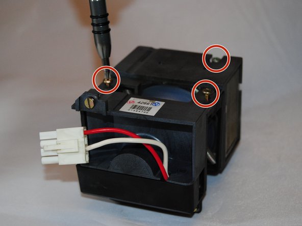

    3. InFocus Screenplay 4805 Lamp Replacement, **REBUILD ONLY** Housing disassembly: crwdns2935265:03crwdnd2935265:01crwdnd2935265:02crwdne2935265:0 InFocus Screenplay 4805 Lamp Replacement, **REBUILD ONLY** Housing disassembly: crwdns2935265:03crwdnd2935265:02crwdnd2935265:02crwdne2935265:0
      • This step is only required when rebuilding the old lamp with a replacement bulb.
      • Slide the bulb housing out of the projector.
      • Use the Phillips #1 screwdriver to remove the three 1 cm gold screws on the bulb housing.

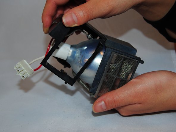

    4. InFocus Screenplay 4805 Lamp Replacement, **REBUILD ONLY** Housing disassembly: crwdns2935265:04crwdnd2935265:01crwdnd2935265:02crwdne2935265:0 InFocus Screenplay 4805 Lamp Replacement, **REBUILD ONLY** Housing disassembly: crwdns2935265:04crwdnd2935265:02crwdnd2935265:02crwdne2935265:0
      • Gently pull the top of the bulb housing off.
      • Lift up the middle of the bulb housing to remove it.
      • Be careful of loose parts, such as the metal housing and the glass focusing lens.

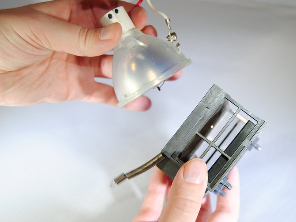

    5. InFocus Screenplay 4805 Lamp Replacement, **REBUILD ONLY** Housing disassembly: crwdns2935265:05crwdnd2935265:01crwdnd2935265:03crwdne2935265:0 InFocus Screenplay 4805 Lamp Replacement, **REBUILD ONLY** Housing disassembly: crwdns2935265:05crwdnd2935265:02crwdnd2935265:03crwdne2935265:0 InFocus Screenplay 4805 Lamp Replacement, **REBUILD ONLY** Housing disassembly: crwdns2935265:05crwdnd2935265:03crwdnd2935265:03crwdne2935265:0
      • Unhook the spring from the bulb housing.
      • Gently remove the bulb.
To reassemble the device, follow these instructions in reverse order.
