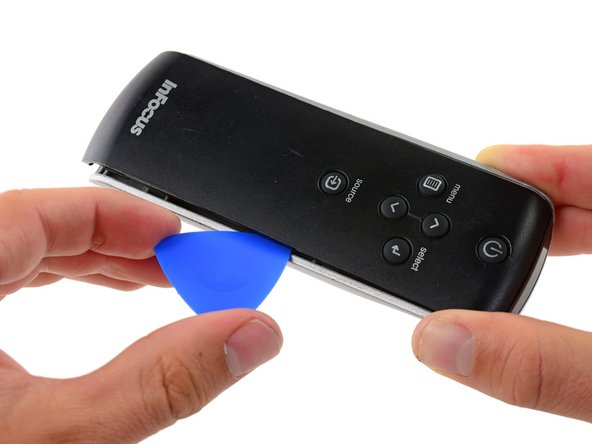

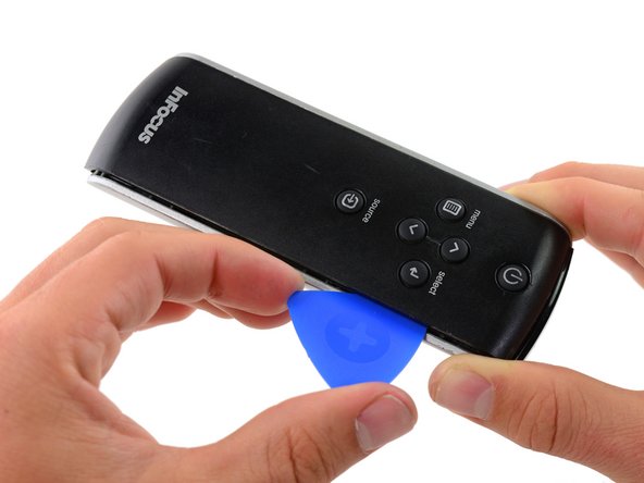

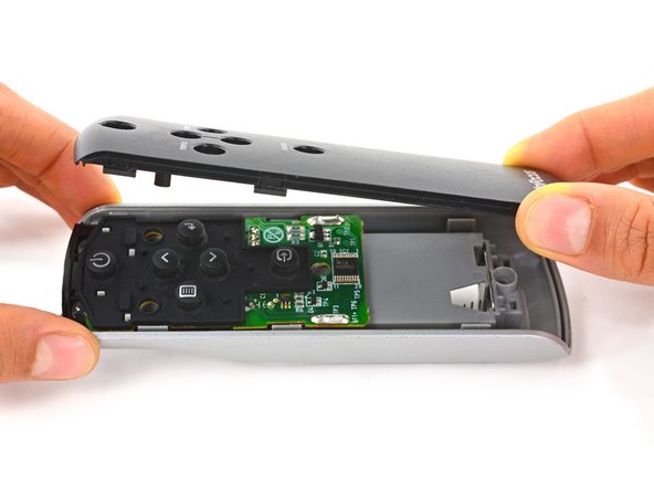

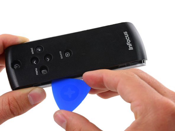

      • Insert a plastic opening tool into the seam between the black top cover and silver base at the bottom edge of the remote.
      • Carefully pry the top cover up and away from the base.
    5. InFocus Remote Button Pad Replacement: crwdns2935265:05crwdnd2935265:01crwdnd2935265:03crwdne2935265:0 InFocus Remote Button Pad Replacement: crwdns2935265:05crwdnd2935265:02crwdnd2935265:03crwdne2935265:0 InFocus Remote Button Pad Replacement: crwdns2935265:05crwdnd2935265:03crwdnd2935265:03crwdne2935265:0

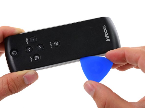

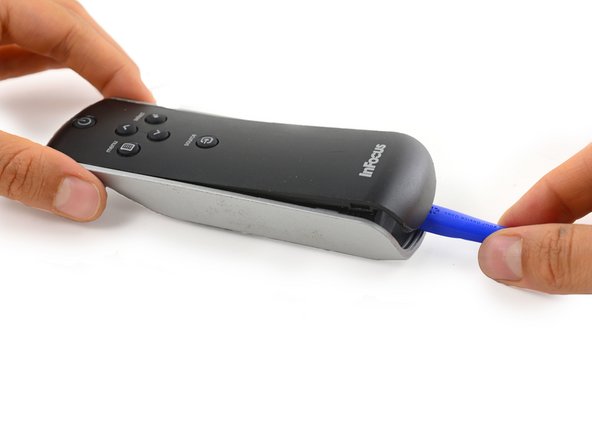

      • Insert an opening pick into the seam on side of the remote, even with the InFocus Label.
      • Slide the opening pick along the side of the remote, moving towards the buttons.
      • There is a plastic tab that holds the covers to the base, located even with the Source button. Push the pick through with a bit more force here to disconnect the cover.
    6. InFocus Remote Button Pad Replacement: crwdns2935265:06crwdnd2935265:01crwdnd2935265:03crwdne2935265:0 InFocus Remote Button Pad Replacement: crwdns2935265:06crwdnd2935265:02crwdnd2935265:03crwdne2935265:0 InFocus Remote Button Pad Replacement: crwdns2935265:06crwdnd2935265:03crwdnd2935265:03crwdne2935265:0
      • Repeat the previous step on the other side of the remote, working from the InFocus label towards the buttons until the entire cover is loose.
    7. InFocus Remote Button Pad Replacement: crwdns2935265:07crwdnd2935265:01crwdnd2935265:02crwdne2935265:0 InFocus Remote Button Pad Replacement: crwdns2935265:07crwdnd2935265:02crwdnd2935265:02crwdne2935265:0
      • Firmly grasp the cover and lift it away from the remote.

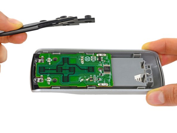

    1. InFocus Remote Button Pad Replacement, Button Pad: crwdns2935265:08crwdnd2935265:01crwdnd2935265:02crwdne2935265:0 InFocus Remote Button Pad Replacement, Button Pad: crwdns2935265:08crwdnd2935265:02crwdnd2935265:02crwdne2935265:0
      • Lift the button pad up and out of the remote.
