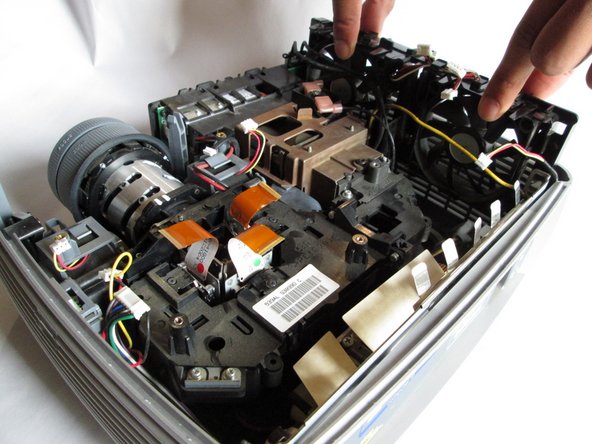

    1. InFocus LP540 Projector Main Fans Replacement, Main Fans: crwdns2935265:07crwdnd2935265:01crwdnd2935265:02crwdne2935265:0 InFocus LP540 Projector Main Fans Replacement, Main Fans: crwdns2935265:07crwdnd2935265:02crwdnd2935265:02crwdne2935265:0
      • Once the main board has been removed, carefully lift the fans upward. Make sure no cables are tangled in the process.
