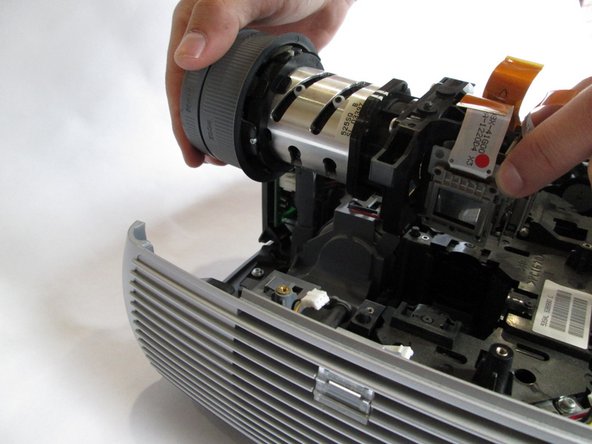

  7. InFocus LP540 Projector Lens Replacement, Lens: crwdns2935265:07crwdnd2935265:01crwdnd2935265:02crwdne2935265:0 InFocus LP540 Projector Lens Replacement, Lens: crwdns2935265:07crwdnd2935265:02crwdnd2935265:02crwdne2935265:0
    • Remove the two 10 mm screws using the Philips 0 screwdriver head.
  8. InFocus LP540 Projector Lens Replacement: crwdns2935265:08crwdnd2935265:01crwdnd2935265:02crwdne2935265:0 InFocus LP540 Projector Lens Replacement: crwdns2935265:08crwdnd2935265:02crwdnd2935265:02crwdne2935265:0
    • Carefully hold the lens from both ends and lift up simultaneously
