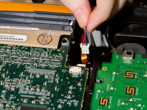

      • Unplug the small ribbon cable connecting the DLP board to the motherboard. It is obstructing the secondary fan power cable.
      • Unplug the secondary fan's power cable from the motherboard.

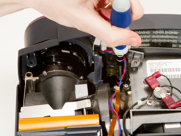

      • Remove the two Phillips #1 8.5mm screws holding the secondary fan in place.
      • The second screw is close to the bottom of the projector and may be difficult to see.
    3. InFocus LP435Z Secondary Fan Replacement: crwdns2935265:08crwdnd2935265:01crwdnd2935265:01crwdne2935265:0
      • Remove the secondary fan, by pulling straight up and out of projector.
