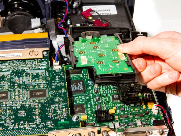

  6. InFocus LP435Z Remote Control Circuit Board Replacement, Remote Control Circuit Board: crwdns2935265:06crwdnd2935265:01crwdnd2935265:02crwdne2935265:0 InFocus LP435Z Remote Control Circuit Board Replacement, Remote Control Circuit Board: crwdns2935265:06crwdnd2935265:02crwdnd2935265:02crwdne2935265:0
    • Finally, to remove the remote control board, simply disconnect it from the logic board underneath it by gently pulling it up from the edge closest to you, wiggling it if necessary..
