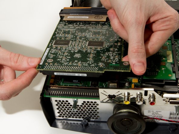

      • Detach the DLP board from where it is connected to the motherboard by a large 100 pin connector.
      • Pry up gently while wiggling from left to right if needed.
      • The ribbon cable on the other side of the board could break if pulled too hard.

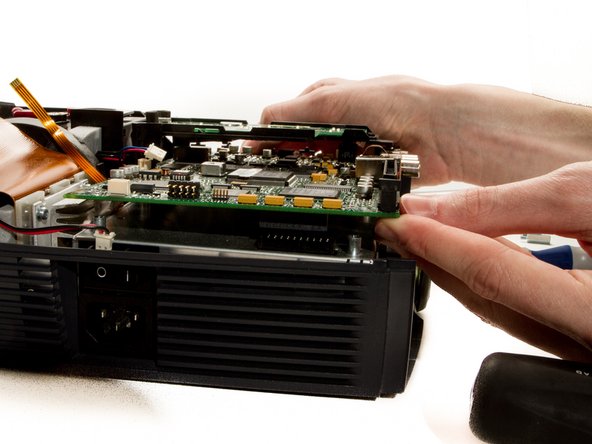

      • Remove the 2 remaining T10 Torx 8mm screws securing the motherboard to the power supply.
    5. InFocus LP435Z Power Supply Replacement: crwdns2935265:010crwdnd2935265:01crwdnd2935265:01crwdne2935265:0

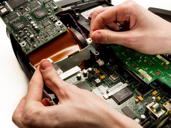

      • Pry out the DLP support piece by gently wiggling it side to side while applying a steady pull. It will slide out.
    9. InFocus LP435Z Power Supply Replacement: crwdns2935265:014crwdnd2935265:01crwdnd2935265:03crwdne2935265:0 InFocus LP435Z Power Supply Replacement: crwdns2935265:014crwdnd2935265:02crwdnd2935265:03crwdne2935265:0 InFocus LP435Z Power Supply Replacement: crwdns2935265:014crwdnd2935265:03crwdnd2935265:03crwdne2935265:0
      • Remove the two 1/4" screws using the nut driver.
      • The second screw is located behind the right side of the 100 pin connector.

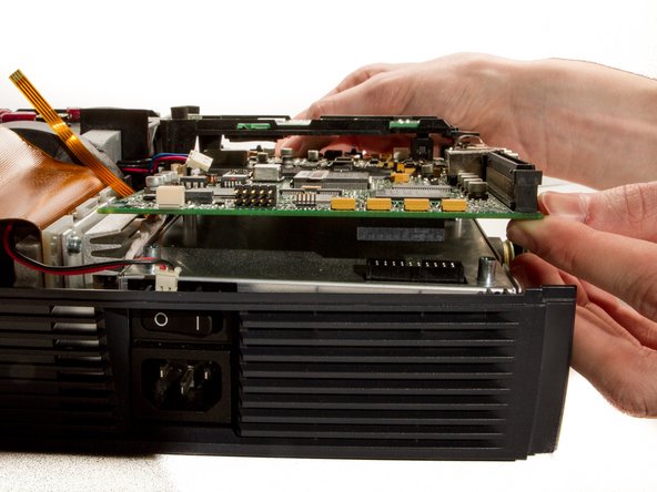

      • Gently pry up the motherboard from the connector on top of the power supply.
    10. InFocus LP435Z Power Supply Replacement: crwdns2935265:015crwdnd2935265:01crwdnd2935265:02crwdne2935265:0 InFocus LP435Z Power Supply Replacement: crwdns2935265:015crwdnd2935265:02crwdnd2935265:02crwdne2935265:0

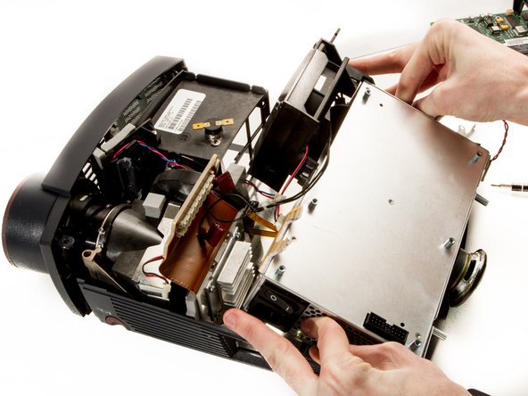

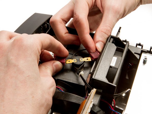

      • Disconnect the lamp power supply cables from the top of the lamp housing, by gently pulling the two wires in opposite directions.
    11. InFocus LP435Z Power Supply Replacement: crwdns2935265:016crwdnd2935265:01crwdnd2935265:03crwdne2935265:0 InFocus LP435Z Power Supply Replacement: crwdns2935265:016crwdnd2935265:02crwdnd2935265:03crwdne2935265:0 InFocus LP435Z Power Supply Replacement: crwdns2935265:016crwdnd2935265:03crwdnd2935265:03crwdne2935265:0
      • Use your thumbs to pry the sides of the external shell away from the power supply so it can be lifted out.
    12. InFocus LP435Z Power Supply Replacement: crwdns2935265:017crwdnd2935265:01crwdnd2935265:03crwdne2935265:0 InFocus LP435Z Power Supply Replacement: crwdns2935265:017crwdnd2935265:02crwdnd2935265:03crwdne2935265:0 InFocus LP435Z Power Supply Replacement: crwdns2935265:017crwdnd2935265:03crwdnd2935265:03crwdne2935265:0

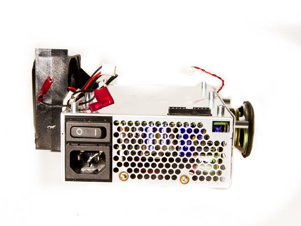

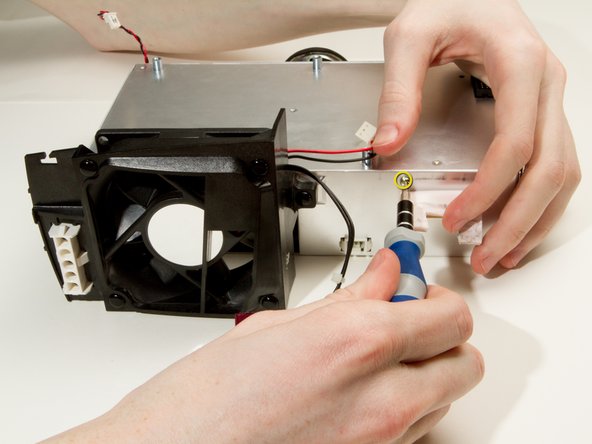

      • Rotate the power supply so that the main fan enclosure faces to the right, with the motherboard mounting pegs on top.
      • Remove the two #2 Phillips 7mm screws on the side of the power supply.
      • Remove two more #2 Phillips 7mm screws on the opposite side of the power supply.
      • Rotate the power supply so the fan faces towards you, and remove a fifth #2 Phillips 7mm screw from just under the foam pad.
    13. InFocus LP435Z Power Supply Replacement: crwdns2935265:018crwdnd2935265:01crwdnd2935265:02crwdne2935265:0 InFocus LP435Z Power Supply Replacement: crwdns2935265:018crwdnd2935265:02crwdnd2935265:02crwdne2935265:0

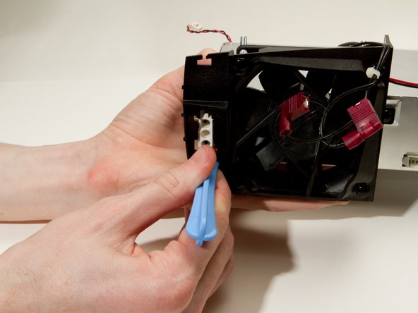

      • Use a plastic prying tool to push the white molex connector through the fan enclosure.

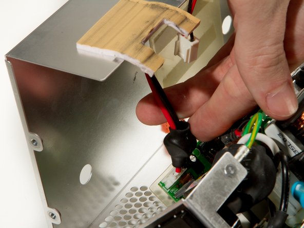

    14. InFocus LP435Z Power Supply Replacement: crwdns2935265:019crwdnd2935265:01crwdnd2935265:02crwdne2935265:0 InFocus LP435Z Power Supply Replacement: crwdns2935265:019crwdnd2935265:02crwdnd2935265:02crwdne2935265:0

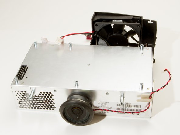

      • Flip the power supply over so that the motherboard mounting pegs are on the bottom.
      • Carefully open the power supply, and be mindful of the cable that will be pulled taut that needs to be disconnected.
      • It may be easier to disconnect this cable if you orient the power supply with the speaker down, so you can reach in more easily.
    15. InFocus LP435Z Power Supply Replacement: crwdns2935265:020crwdnd2935265:01crwdnd2935265:01crwdne2935265:0
      • The base of the power supply should now be free.
