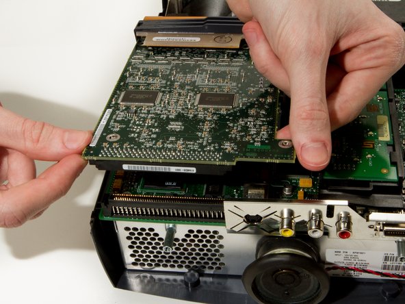

    1. InFocus LP435Z DLP Board Replacement, DLP Board: crwdns2935265:06crwdnd2935265:01crwdnd2935265:01crwdne2935265:0
      • Remove the four T10 Torx 8.5 mm screws holding the DLP board in place.
    2. InFocus LP435Z DLP Board Replacement: crwdns2935265:07crwdnd2935265:01crwdnd2935265:01crwdne2935265:0
      • Unplug the small ribbon cable attaching the DLP board to the motherboard.
    3. InFocus LP435Z DLP Board Replacement: crwdns2935265:08crwdnd2935265:01crwdnd2935265:02crwdne2935265:0 InFocus LP435Z DLP Board Replacement: crwdns2935265:08crwdnd2935265:02crwdnd2935265:02crwdne2935265:0
      • Detach the DLP board from where it is connected to the motherboard by a large 100 pin connector.
      • Pry up gently while wiggling from left to right if needed.
      • The ribbon cable on the other side of the board could break if pulled too hard.

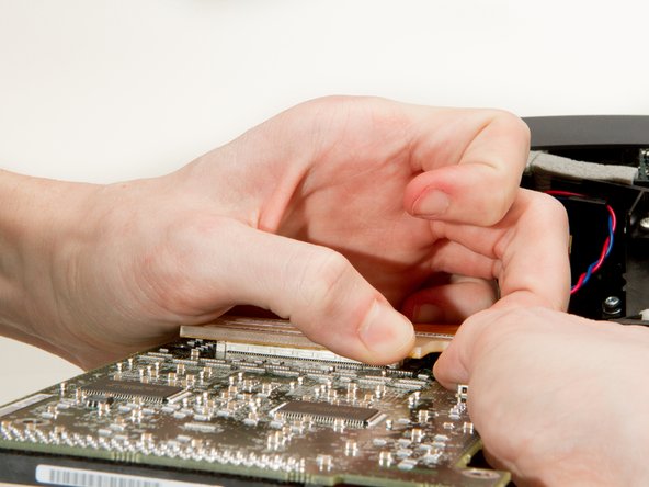

    4. InFocus LP435Z DLP Board Replacement: crwdns2935265:09crwdnd2935265:01crwdnd2935265:02crwdne2935265:0 InFocus LP435Z DLP Board Replacement: crwdns2935265:09crwdnd2935265:02crwdnd2935265:02crwdne2935265:0
      • Remove the black plastic retaining clip reinforcing the large ribbon cable connector by prying it from the left edge.
      • Gently pry the large ribbon cable connector from the DLP board, and remove the board.
      • Using too much force could damage the connector.
