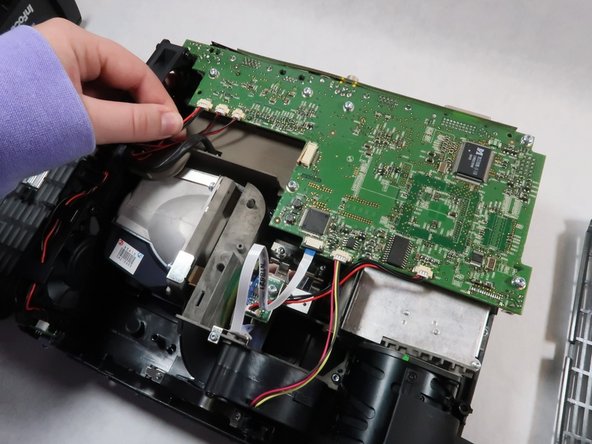

  4. InFocus IN35W Fan Replacement, Motherboard: crwdns2935265:04crwdnd2935265:01crwdnd2935265:02crwdne2935265:0 InFocus IN35W Fan Replacement, Motherboard: crwdns2935265:04crwdnd2935265:02crwdnd2935265:02crwdne2935265:0
    • Detach all six of the cables and speaker wires from the white connectors on the motherboard.

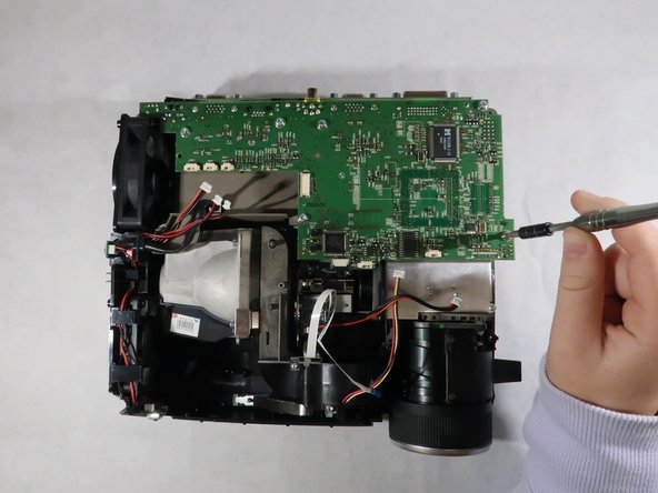

  5. InFocus IN35W Fan Replacement: crwdns2935265:05crwdnd2935265:01crwdnd2935265:02crwdne2935265:0 InFocus IN35W Fan Replacement: crwdns2935265:05crwdnd2935265:02crwdnd2935265:02crwdne2935265:0
    • Remove the six 4 mm Torx TR10 screws from the motherboard.

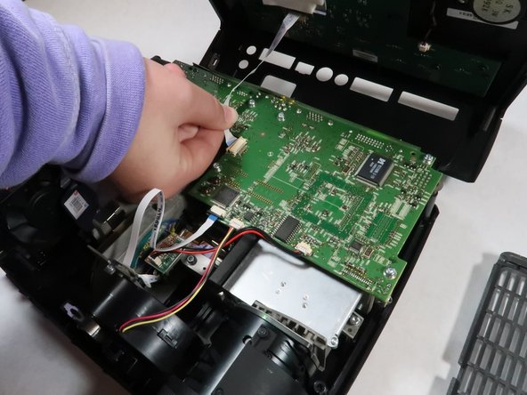

  6. InFocus IN35W Fan Replacement: crwdns2935265:06crwdnd2935265:01crwdnd2935265:01crwdne2935265:0
    • Carefully grasp the outsides of the motherboard and pull it up to remove it from the device.

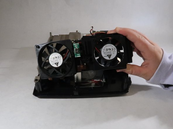

  7. InFocus IN35W Fan Replacement, Fan: crwdns2935265:07crwdnd2935265:01crwdnd2935265:02crwdne2935265:0 InFocus IN35W Fan Replacement, Fan: crwdns2935265:07crwdnd2935265:02crwdnd2935265:02crwdne2935265:0
    • The fan is located on the side of the device.
    • Lift the fan up and out of the projector body.
