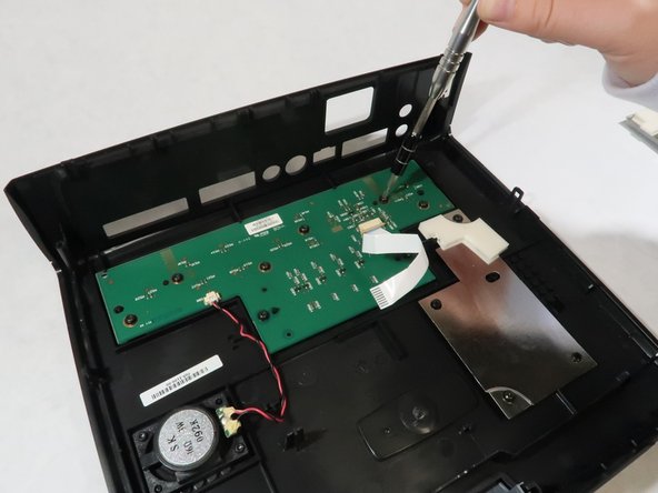

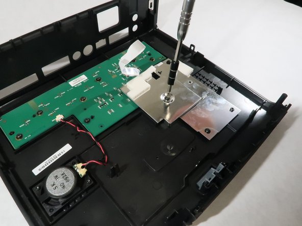

  4. InFocus IN35W Daughterboard Replacement, Daughterboard: crwdns2935265:04crwdnd2935265:01crwdnd2935265:02crwdne2935265:0 InFocus IN35W Daughterboard Replacement, Daughterboard: crwdns2935265:04crwdnd2935265:02crwdnd2935265:02crwdne2935265:0
    • Remove one 7 mm screw from the silver fastening plate using a Torx T9 screwdriver.

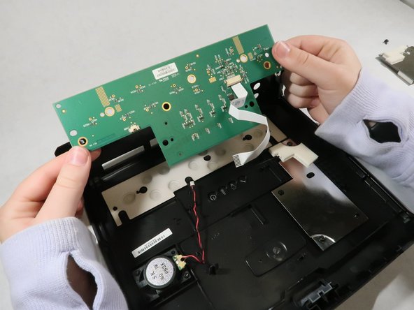

  5. InFocus IN35W Daughterboard Replacement: crwdns2935265:05crwdnd2935265:01crwdnd2935265:02crwdne2935265:0 InFocus IN35W Daughterboard Replacement: crwdns2935265:05crwdnd2935265:02crwdnd2935265:02crwdne2935265:0
    • Remove eight 7 mm screws from the daughterboard using a Torx T9 screwdriver.
  6. InFocus IN35W Daughterboard Replacement: crwdns2935265:06crwdnd2935265:01crwdnd2935265:02crwdne2935265:0 InFocus IN35W Daughterboard Replacement: crwdns2935265:06crwdnd2935265:02crwdnd2935265:02crwdne2935265:0
    • Disconnect the red and black bundled cable from its connector on the daughterboard.
    • Grab the daughterboard by the sides and carefully lift it out from the top plate.
