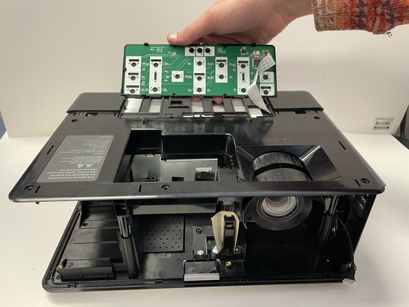

    • Use a Phillips #1 screwdriver to remove the 1.2 cm Phillips-head screw from each side of the projector.
  2. InFocus IN3114 LED Touch Board Replacement: crwdns2935265:02crwdnd2935265:01crwdnd2935265:03crwdne2935265:0 InFocus IN3114 LED Touch Board Replacement: crwdns2935265:02crwdnd2935265:02crwdnd2935265:03crwdne2935265:0 InFocus IN3114 LED Touch Board Replacement: crwdns2935265:02crwdnd2935265:03crwdnd2935265:03crwdne2935265:0
    • Use your hands to slide the top plate off of the projector.
    • Lift and remove the plate.

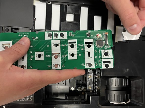

  3. InFocus IN3114 LED Touch Board Replacement, LED Touch Board: crwdns2935265:03crwdnd2935265:01crwdnd2935265:02crwdne2935265:0 InFocus IN3114 LED Touch Board Replacement, LED Touch Board: crwdns2935265:03crwdnd2935265:02crwdnd2935265:02crwdne2935265:0
    • Use the opening tool to lift the control panel cover.
    • Remove the cover.

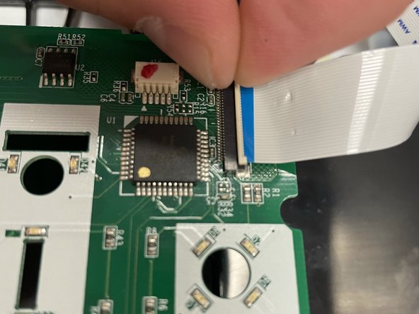

  4. InFocus IN3114 LED Touch Board Replacement: crwdns2935265:04crwdnd2935265:01crwdnd2935265:03crwdne2935265:0 InFocus IN3114 LED Touch Board Replacement: crwdns2935265:04crwdnd2935265:02crwdnd2935265:03crwdne2935265:0 InFocus IN3114 LED Touch Board Replacement: crwdns2935265:04crwdnd2935265:03crwdnd2935265:03crwdne2935265:0
