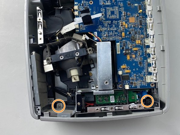

  5. InFocus IN3104 Speaker Replacement, Speaker: crwdns2935265:05crwdnd2935265:01crwdnd2935265:02crwdne2935265:0 InFocus IN3104 Speaker Replacement, Speaker: crwdns2935265:05crwdnd2935265:02crwdnd2935265:02crwdne2935265:0
    • Unplug the speaker wire that is located right behind the cooling fan.
    • Use a Phillips #1 screwdriver to remove the two 6 mm screws on the frame brackets.
  6. InFocus IN3104 Speaker Replacement: crwdns2935265:06crwdnd2935265:01crwdnd2935265:03crwdne2935265:0 InFocus IN3104 Speaker Replacement: crwdns2935265:06crwdnd2935265:02crwdnd2935265:03crwdne2935265:0 InFocus IN3104 Speaker Replacement: crwdns2935265:06crwdnd2935265:03crwdnd2935265:03crwdne2935265:0
    • Remove the side panel.
    • Use a Phillips #1 screwdriver to remove the two 6 mm screws.
    • Remove the speaker by pulling it straight out.
