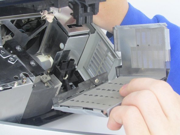

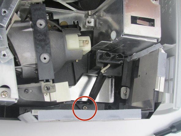

    1. InFocus IN3104 Filter Replacement, Filter: crwdns2935265:03crwdnd2935265:01crwdnd2935265:03crwdne2935265:0 InFocus IN3104 Filter Replacement, Filter: crwdns2935265:03crwdnd2935265:02crwdnd2935265:03crwdne2935265:0 InFocus IN3104 Filter Replacement, Filter: crwdns2935265:03crwdnd2935265:03crwdnd2935265:03crwdne2935265:0
      • Use a Phillips # 1 screw driver to remove the 6 mm screw that secures the filter.
      • Once the screw is removed, remove the filter by pulling it straight out.
