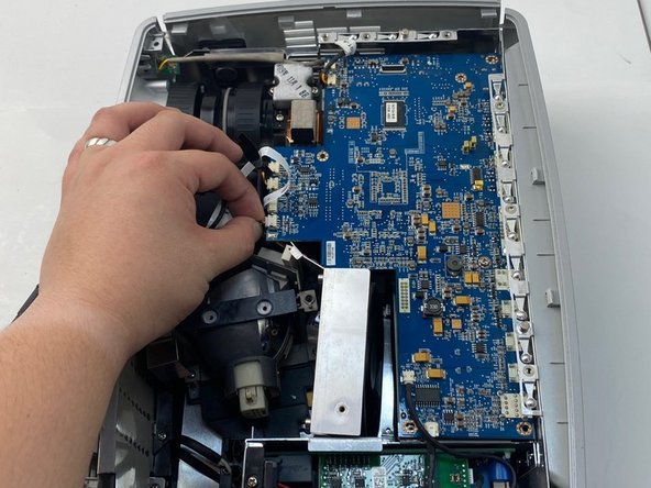

    1. InFocus IN3104 Cooling Fan Replacement, InFocus IN3104 Metal Cover Disassembly: crwdns2935265:03crwdnd2935265:01crwdnd2935265:02crwdne2935265:0 InFocus IN3104 Cooling Fan Replacement, InFocus IN3104 Metal Cover Disassembly: crwdns2935265:03crwdnd2935265:02crwdnd2935265:02crwdne2935265:0
      • Use a Phillips #1 screwdriver to remove the nine 6 mm screws.
      • Lift up the metal cover and set it aside to reveal the motherboard.
    2. InFocus IN3104 Cooling Fan Replacement: crwdns2935265:04crwdnd2935265:01crwdnd2935265:03crwdne2935265:0 InFocus IN3104 Cooling Fan Replacement: crwdns2935265:04crwdnd2935265:02crwdnd2935265:03crwdne2935265:0 InFocus IN3104 Cooling Fan Replacement: crwdns2935265:04crwdnd2935265:03crwdnd2935265:03crwdne2935265:0
      • Carefully pry up the black plastic locking bar of the ZIF connector on the motherboard with a plastic spudger.
      • Pull out the blue-tipped, white ribbon cable from the connector.
      • Remove the metal cover.

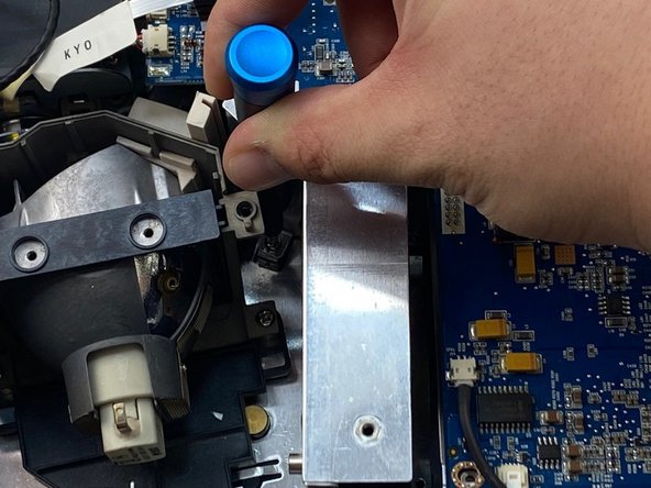

    1. InFocus IN3104 Cooling Fan Replacement, Cooling Fan: crwdns2935265:05crwdnd2935265:01crwdnd2935265:02crwdne2935265:0 InFocus IN3104 Cooling Fan Replacement, Cooling Fan: crwdns2935265:05crwdnd2935265:02crwdnd2935265:02crwdne2935265:0
      • Use a Phillips #1 screwdriver to remove the three 6 mm screws on the metal cover beside the lamp.
      • The screws are in a tight location, so you may need a thin screwdriver or an extension to remove them.
    2. InFocus IN3104 Cooling Fan Replacement: crwdns2935265:06crwdnd2935265:01crwdnd2935265:03crwdne2935265:0 InFocus IN3104 Cooling Fan Replacement: crwdns2935265:06crwdnd2935265:02crwdnd2935265:03crwdne2935265:0 InFocus IN3104 Cooling Fan Replacement: crwdns2935265:06crwdnd2935265:03crwdnd2935265:03crwdne2935265:0
      • Unplug the yellow, red, and black colored cable bundle from the motherboard.
      • Remove the cooling fan from the device by lifting it out.
