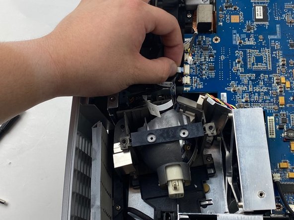

      • Carefully pry up the black plastic locking bar of the ZIF connector on the motherboard with a plastic spudger.
      • Pull out the blue-tipped, white ribbon cable from the connector.
      • Remove the metal cover.

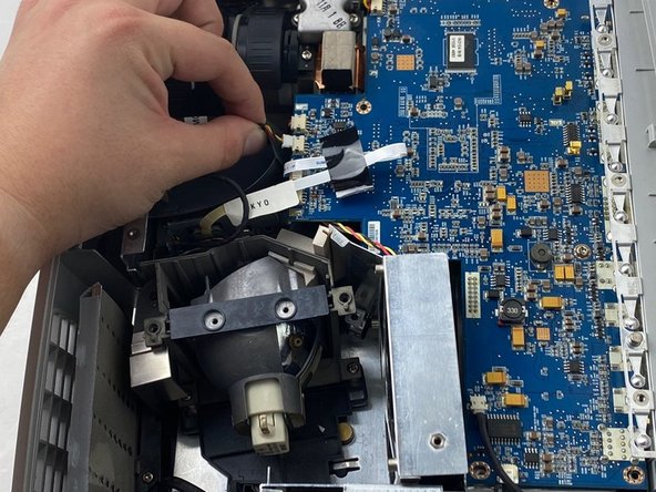

    1. InFocus IN3104 Color Wheel Replacement, Color Wheel: crwdns2935265:05crwdnd2935265:01crwdnd2935265:03crwdne2935265:0 InFocus IN3104 Color Wheel Replacement, Color Wheel: crwdns2935265:05crwdnd2935265:02crwdnd2935265:03crwdne2935265:0 InFocus IN3104 Color Wheel Replacement, Color Wheel: crwdns2935265:05crwdnd2935265:03crwdnd2935265:03crwdne2935265:0
      • Unplug two cables from the edge of the motherboard labeled 80.87 MO and KYO.

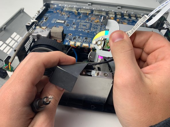

    2. InFocus IN3104 Color Wheel Replacement: crwdns2935265:06crwdnd2935265:01crwdnd2935265:02crwdne2935265:0 InFocus IN3104 Color Wheel Replacement: crwdns2935265:06crwdnd2935265:02crwdnd2935265:02crwdne2935265:0
      • Carefully lift up the black paper cover. Do not completely remove it from the device.
      • Lift the paper cover up to reveal two 6mm screws.

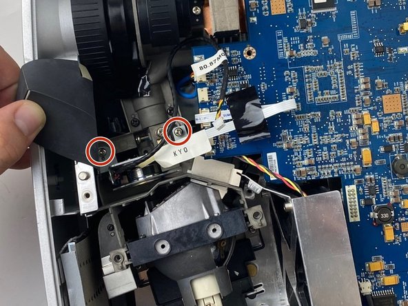

    3. InFocus IN3104 Color Wheel Replacement: crwdns2935265:07crwdnd2935265:01crwdnd2935265:02crwdne2935265:0 InFocus IN3104 Color Wheel Replacement: crwdns2935265:07crwdnd2935265:02crwdnd2935265:02crwdne2935265:0
      • Use a Phillips #1 screwdriver to remove the two 6mm screws.
      • Remove the color wheel from the device by lifting it out of the projector.
