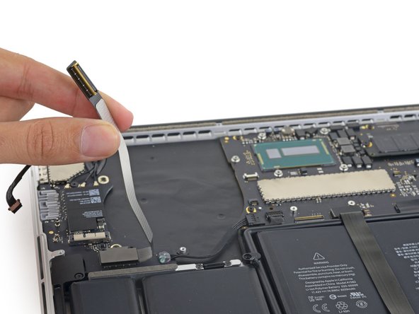

  4. In-Place Fan Cover Removal, Disconnect I/O board cable: crwdns2935265:04crwdnd2935265:01crwdnd2935265:02crwdne2935265:0 In-Place Fan Cover Removal, Disconnect I/O board cable: crwdns2935265:04crwdnd2935265:02crwdnd2935265:02crwdne2935265:0
    • One of the screws holding the top shell of the fan assembly is hidden just behind the I/O board cable.
    • Remove the two 2.1 mm T5 Torx screws securing the I/O board cable bracket to the logic board.
    • Remove the I/O board cable bracket.
  5. In-Place Fan Cover Removal: crwdns2935265:05crwdnd2935265:01crwdnd2935265:02crwdne2935265:0 In-Place Fan Cover Removal: crwdns2935265:05crwdnd2935265:02crwdnd2935265:02crwdne2935265:0
    • Use the flat end of a spudger to pop the I/O board connector straight up off its socket on the logic board.
    • Be careful to only pry up on the I/O board cable, not on the socket itself or you risk damaging your logic board.
  6. In-Place Fan Cover Removal: crwdns2935265:06crwdnd2935265:01crwdnd2935265:02crwdne2935265:0 In-Place Fan Cover Removal: crwdns2935265:06crwdnd2935265:02crwdnd2935265:02crwdne2935265:0
    • Lift the logic board end of the I/O board cable straight up to bend it out of the way.
    • To avoid damage to the cable, fold only at the bend in the I/O board end of the cable. It will only be in the way momentarily, so don't try forcing it to stay.
