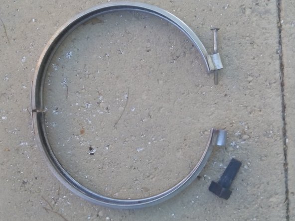

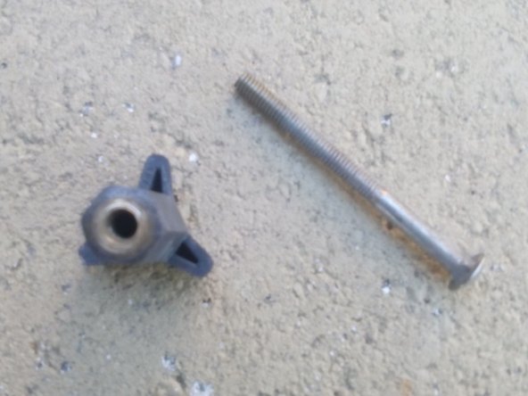

      • Unscrew the metal ring bracket that is on the filter housing in order to remove the top half of the filter housing (lid). Turn the handle in a counter-clock wise motion until it is completely loose and the screw can be removed.
    3. In-Ground Pool Filter Replacement: crwdns2935265:03crwdnd2935265:01crwdnd2935265:03crwdne2935265:0 In-Ground Pool Filter Replacement: crwdns2935265:03crwdnd2935265:02crwdnd2935265:03crwdne2935265:0 In-Ground Pool Filter Replacement: crwdns2935265:03crwdnd2935265:03crwdnd2935265:03crwdne2935265:0
      • Take the metal ring bracket off.

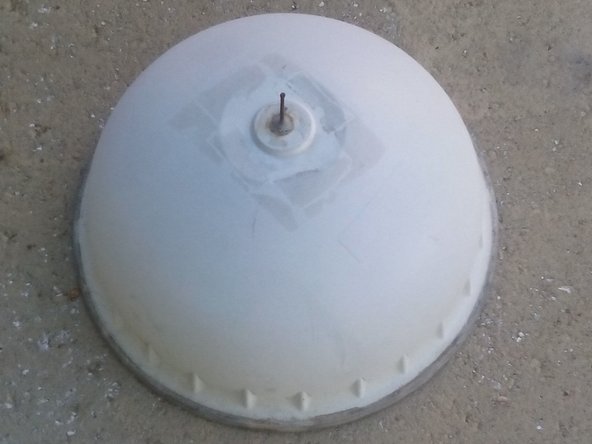

      • Remove the top half of the filter housing.

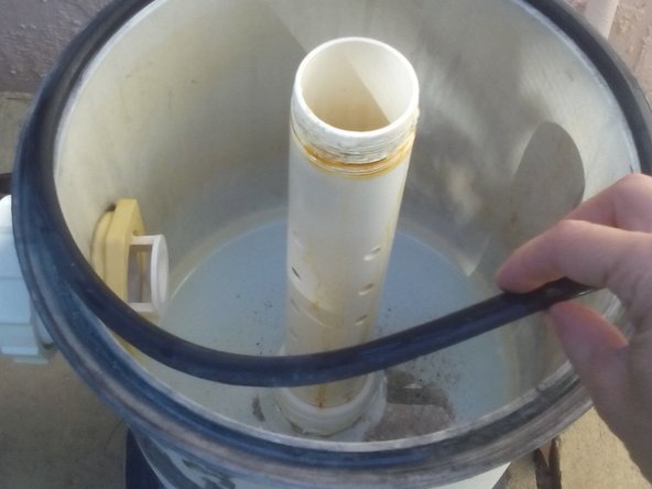

    5. In-Ground Pool Filter Replacement: crwdns2935265:05crwdnd2935265:01crwdnd2935265:03crwdne2935265:0 In-Ground Pool Filter Replacement: crwdns2935265:05crwdnd2935265:02crwdnd2935265:03crwdne2935265:0 In-Ground Pool Filter Replacement: crwdns2935265:05crwdnd2935265:03crwdnd2935265:03crwdne2935265:0

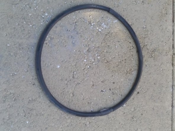

      • Remove the O-ring.

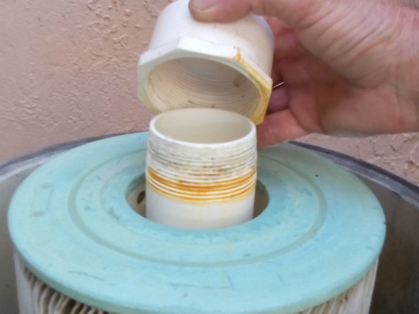

    6. In-Ground Pool Filter Replacement: crwdns2935265:06crwdnd2935265:01crwdnd2935265:03crwdne2935265:0 In-Ground Pool Filter Replacement: crwdns2935265:06crwdnd2935265:02crwdnd2935265:03crwdne2935265:0 In-Ground Pool Filter Replacement: crwdns2935265:06crwdnd2935265:03crwdnd2935265:03crwdne2935265:0

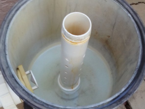

      • Unscrew the filter cap in a counter clock wise motion until it comes off.

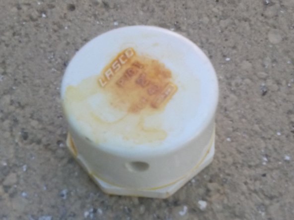

    7. In-Ground Pool Filter Replacement: crwdns2935265:07crwdnd2935265:01crwdnd2935265:03crwdne2935265:0 In-Ground Pool Filter Replacement: crwdns2935265:07crwdnd2935265:02crwdnd2935265:03crwdne2935265:0 In-Ground Pool Filter Replacement: crwdns2935265:07crwdnd2935265:03crwdnd2935265:03crwdne2935265:0

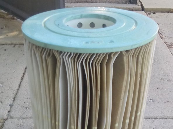

      • Take the pool filter out and place on the ground. Put the new filter in and to put it all back together you can simply follow these directions in reverse order.
      • While the filter housing is apart, you should inspect the O-ring to determine if it has any cracks or tears. If so, replace it with a new O-ring. If it still appears to be in decent condition, then continue to use it and apply a little lube. NEVER use Vaseline or any other petroleum-based lubricant on pool parts. Look for silicone-based lubes.
