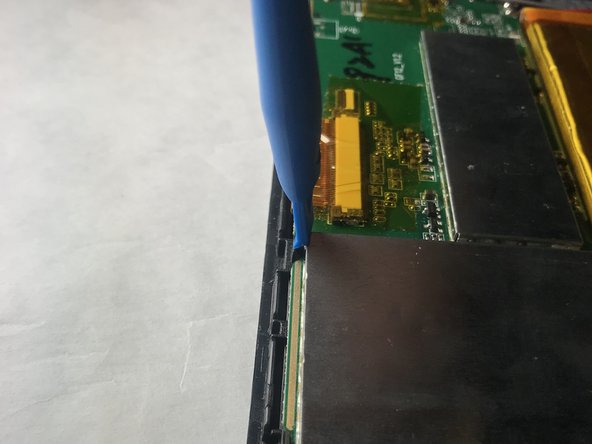

    • Wedge the plastic opening tool into the seam nearest to the screen surface and begin to pry off the back of the device.
  2. Impression i7 USB Port Replacement: crwdns2935265:02crwdnd2935265:01crwdnd2935265:01crwdne2935265:0
    • Move the plastic opening tool along the perimeter of the device, loosening the entire back as you go.

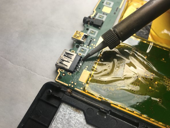

    • Desolder the eight solder joints holding the USB Port in place.
