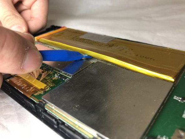

    • Remove the transparent, orange tape from the edge of the battery.
    • Pry the battery off, using the plastic opening tool.

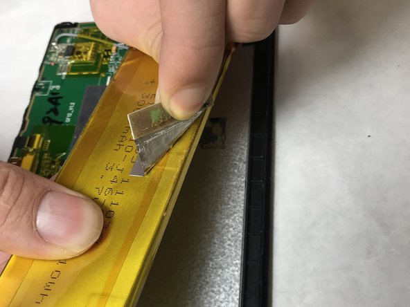

    • Pull the battery away from the adhesive.
    • Peel the gray tape from the top of the battery.
