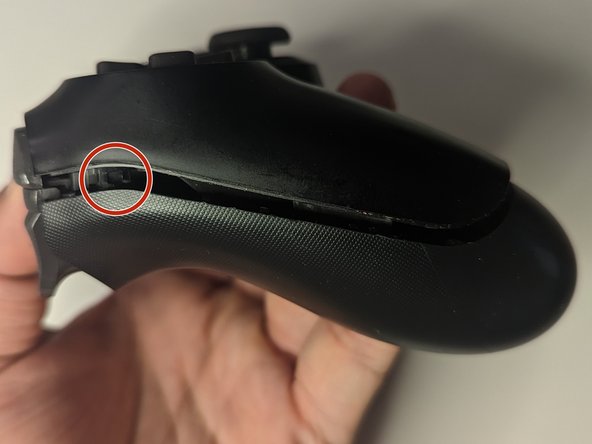

  2. Important Step For Opening the DualShock 4 CUH-ZCT2U, Unlatch the side clip (right side): crwdns2935265:02crwdnd2935265:01crwdnd2935265:03crwdne2935265:0 Important Step For Opening the DualShock 4 CUH-ZCT2U, Unlatch the side clip (right side): crwdns2935265:02crwdnd2935265:02crwdnd2935265:03crwdne2935265:0 Important Step For Opening the DualShock 4 CUH-ZCT2U, Unlatch the side clip (right side): crwdns2935265:02crwdnd2935265:03crwdnd2935265:03crwdne2935265:0
    • There are two more clips to unlatch, one on each side of the controller near the shoulder buttons; once again, this photo shows how your controller will look after the clips are unlatched, so your gap will be much smaller
    • Insert your tool at the location indicated on the right (buttons) side of the controller and repeat the previous step for unlatching this clip

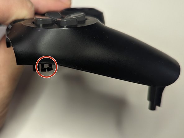

  3. Important Step For Opening the DualShock 4 CUH-ZCT2U, Unlatch the side clip (left side): crwdns2935265:03crwdnd2935265:01crwdnd2935265:03crwdne2935265:0 Important Step For Opening the DualShock 4 CUH-ZCT2U, Unlatch the side clip (left side): crwdns2935265:03crwdnd2935265:02crwdnd2935265:03crwdne2935265:0 Important Step For Opening the DualShock 4 CUH-ZCT2U, Unlatch the side clip (left side): crwdns2935265:03crwdnd2935265:03crwdnd2935265:03crwdne2935265:0
    • Repeat the previous step on the left (d-pad) side of the controller
    • (Note that my clip here is broken because I tried to force the casing open.)
The controller should now open easily. Take care not to damage the ribbon cable still connecting the top and bottom cases. You can now proceed to the next step in your guide.
