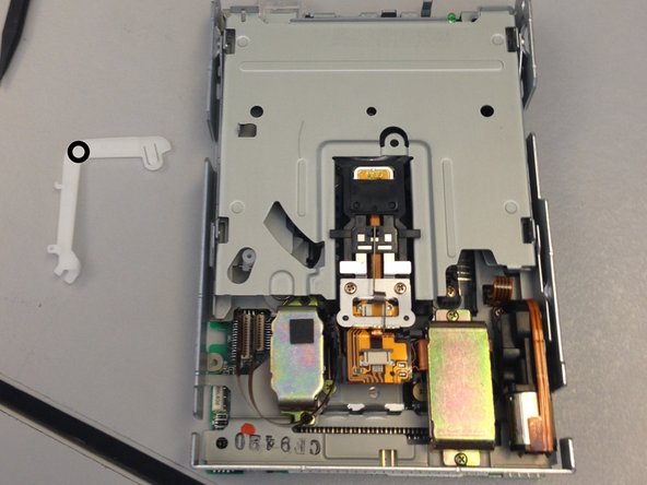

  14. Imation Superdisk USB Drive Plastic Arm Replacement, Plastic Arm: crwdns2935265:014crwdnd2935265:01crwdnd2935265:01crwdne2935265:0
    • Flip the device over so the plastic arm is face up.
  15. Imation Superdisk USB Drive Plastic Arm Replacement: crwdns2935265:015crwdnd2935265:01crwdnd2935265:02crwdne2935265:0 Imation Superdisk USB Drive Plastic Arm Replacement: crwdns2935265:015crwdnd2935265:02crwdnd2935265:02crwdne2935265:0
    • Remove the small spring that connects the plastic arm to the disk drive.
    • To the keep the spring from flying in the air and getting lost, put your finger on one end of the spring to hold it in place while you detach the other end. It does not matter which end you chose to detach first.

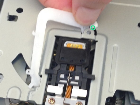

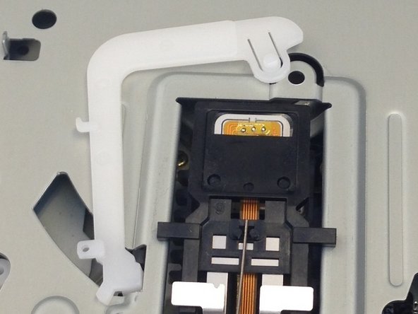

  16. Imation Superdisk USB Drive Plastic Arm Replacement: crwdns2935265:016crwdnd2935265:01crwdnd2935265:03crwdne2935265:0 Imation Superdisk USB Drive Plastic Arm Replacement: crwdns2935265:016crwdnd2935265:02crwdnd2935265:03crwdne2935265:0 Imation Superdisk USB Drive Plastic Arm Replacement: crwdns2935265:016crwdnd2935265:03crwdnd2935265:03crwdne2935265:0
    • Locate the tab with a raised dot on the immobile end of the plastic arm.
    • Apply pressure on the plastic tab and slide it backwards to release that end of the arm from the disk drive.

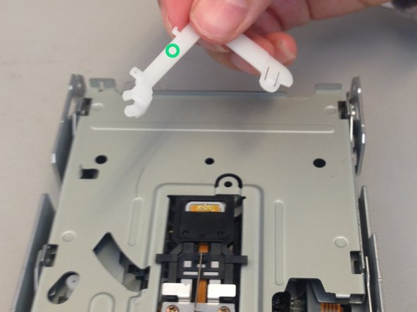

  17. Imation Superdisk USB Drive Plastic Arm Replacement: crwdns2935265:017crwdnd2935265:01crwdnd2935265:03crwdne2935265:0 Imation Superdisk USB Drive Plastic Arm Replacement: crwdns2935265:017crwdnd2935265:02crwdnd2935265:03crwdne2935265:0 Imation Superdisk USB Drive Plastic Arm Replacement: crwdns2935265:017crwdnd2935265:03crwdnd2935265:03crwdne2935265:0
    • Rotate the plastic arm until it fits through the opening in the disk drive and pull it out.
    • Completely remove the plastic arm from the disk drive.
    • Replace the arm if it is broken or set it aside and continue to your next task.
