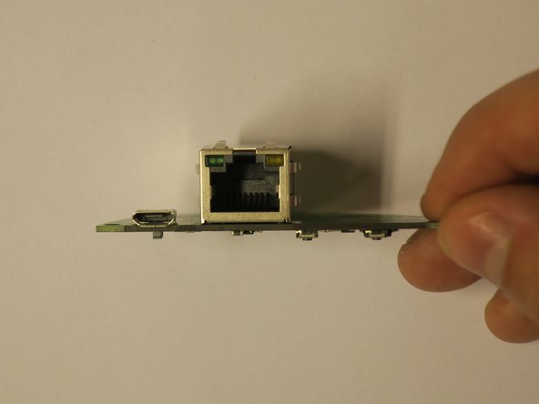

    • A tiny PCB!
    • Wow, that is one tiny PCB.
    • The PCB is held in place by 3 Phillips head screws.
  7. Ikea TRÅDFRI Gateway Teardown: crwdns2935265:07crwdnd2935265:01crwdnd2935265:03crwdne2935265:0 Ikea TRÅDFRI Gateway Teardown: crwdns2935265:07crwdnd2935265:02crwdnd2935265:03crwdne2935265:0 Ikea TRÅDFRI Gateway Teardown: crwdns2935265:07crwdnd2935265:03crwdnd2935265:03crwdne2935265:0
    • A mysterious unpopulated footprint, can I hear "debug connector"?
    • ISSI IS25CQ032 32 Mbit Quad-SPI Flash
    • Murata Type1GC 2.4GHz & 5GHz Wi-FI Module
    • The module includes the Cypress BCM43907 Wireless System SoC
    • Broadcom BCM5241 Fast Ethernet Transceiver
    • Silicon Labs Mighty Gecko EFR32MG1P132GI Zigbee and Thread Multiprotocol SoC
    • Seems to be the same SoC as the one used in the Ikea bulbs.
    • 934 3959 1624 - With the recent announcement that the gateway will work with Apple's HomeKit, it's possible this is the MFi chip
  8. Ikea TRÅDFRI Gateway Teardown: crwdns2935265:08crwdnd2935265:01crwdnd2935265:03crwdne2935265:0 Ikea TRÅDFRI Gateway Teardown: crwdns2935265:08crwdnd2935265:02crwdnd2935265:03crwdne2935265:0 Ikea TRÅDFRI Gateway Teardown: crwdns2935265:08crwdnd2935265:03crwdnd2935265:03crwdne2935265:0
    • A closer look at the Wi-Fi/Ethernet/Zigbee parts.
  9. Ikea TRÅDFRI Gateway Teardown: crwdns2935265:09crwdnd2935265:01crwdnd2935265:03crwdne2935265:0 Ikea TRÅDFRI Gateway Teardown: crwdns2935265:09crwdnd2935265:02crwdnd2935265:03crwdne2935265:0 Ikea TRÅDFRI Gateway Teardown: crwdns2935265:09crwdnd2935265:03crwdnd2935265:03crwdne2935265:0
    • Another look at the other parts.
