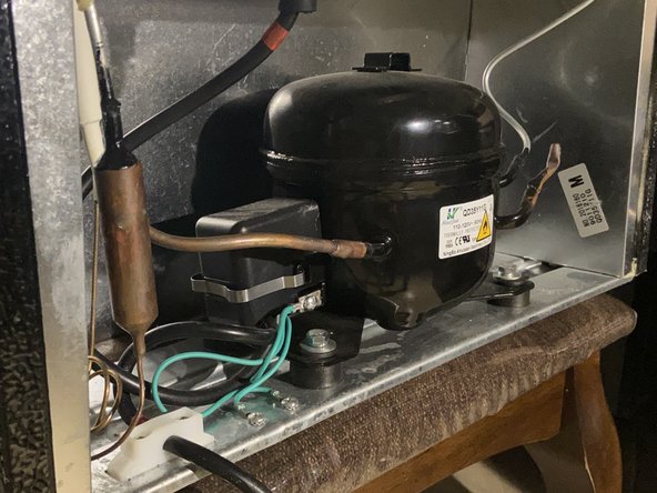

    • Clear out all food products in the refrigerator.
    • Unplug the plug from the outlet.
    • Turn the refrigerator backward.
    • Don't turn the mini fridge on its side. Doing so will ruin the mini fridge gas.
  2. Igloo Mini Fridge IRF32BK Compressor Relay Replacement: crwdns2935265:02crwdnd2935265:01crwdnd2935265:03crwdne2935265:0 Igloo Mini Fridge IRF32BK Compressor Relay Replacement: crwdns2935265:02crwdnd2935265:02crwdnd2935265:03crwdne2935265:0 Igloo Mini Fridge IRF32BK Compressor Relay Replacement: crwdns2935265:02crwdnd2935265:03crwdnd2935265:03crwdne2935265:0

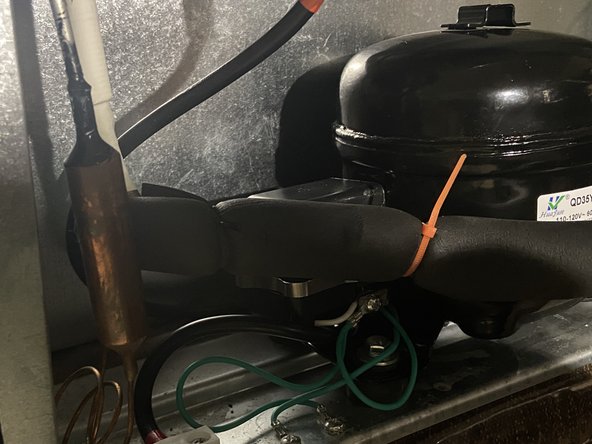

    • Use a knife to cut the plastic holding strips.
    • Don't damage the rubber covering. Damaging it can be dangerous when turning the mini fridge back on.
  3. Igloo Mini Fridge IRF32BK Compressor Relay Replacement: crwdns2935265:03crwdnd2935265:01crwdnd2935265:02crwdne2935265:0 Igloo Mini Fridge IRF32BK Compressor Relay Replacement: crwdns2935265:03crwdnd2935265:02crwdnd2935265:02crwdne2935265:0
    • Use your thumbs to open the rubber covering.
  4. Igloo Mini Fridge IRF32BK Compressor Relay Replacement: crwdns2935265:04crwdnd2935265:01crwdnd2935265:03crwdne2935265:0 Igloo Mini Fridge IRF32BK Compressor Relay Replacement: crwdns2935265:04crwdnd2935265:02crwdnd2935265:03crwdne2935265:0 Igloo Mini Fridge IRF32BK Compressor Relay Replacement: crwdns2935265:04crwdnd2935265:03crwdnd2935265:03crwdne2935265:0
    • Use the CR-V screwdriver to unscrew the screw by rotating the screwdriver counter clockwise.
  5. Igloo Mini Fridge IRF32BK Compressor Relay Replacement: crwdns2935265:05crwdnd2935265:01crwdnd2935265:02crwdne2935265:0 Igloo Mini Fridge IRF32BK Compressor Relay Replacement: crwdns2935265:05crwdnd2935265:02crwdnd2935265:02crwdne2935265:0
    • Push the flathead screwdriver upward to pry open the metal hinge.
    • Repeat this same step on the other side.
  6. Igloo Mini Fridge IRF32BK Compressor Relay Replacement: crwdns2935265:06crwdnd2935265:01crwdnd2935265:02crwdne2935265:0 Igloo Mini Fridge IRF32BK Compressor Relay Replacement: crwdns2935265:06crwdnd2935265:02crwdnd2935265:02crwdne2935265:0
    • Remove the plastic box by pulling it away from the wires.
  7. Igloo Mini Fridge IRF32BK Compressor Relay Replacement: crwdns2935265:07crwdnd2935265:01crwdnd2935265:01crwdne2935265:0
    • Stick the flathead screwdriver in between the compressor relay and the pot.
    • Wiggle the screwdriver left to right five times.
    • Use your hand to pull the compressor relay from the pot.
  8. Igloo Mini Fridge IRF32BK Compressor Relay Replacement: crwdns2935265:08crwdnd2935265:01crwdnd2935265:01crwdne2935265:0
    • Use the flathead screwdriver to push the white cable against the compressor relay to disconnect it.
  9. Igloo Mini Fridge IRF32BK Compressor Relay Replacement: crwdns2935265:09crwdnd2935265:01crwdnd2935265:01crwdne2935265:0
    • Connect the white cable to the new compressor relay.
    • You should hear a click when you connect it correctly.
  10. Igloo Mini Fridge IRF32BK Compressor Relay Replacement: crwdns2935265:010crwdnd2935265:01crwdnd2935265:02crwdne2935265:0 Igloo Mini Fridge IRF32BK Compressor Relay Replacement: crwdns2935265:010crwdnd2935265:02crwdnd2935265:02crwdne2935265:0
    • Connect the holes on the compressor relay to the pot.
    • Connect the top hole on the white part of the compressor relay first, then connect the rest of the holes.
  11. Igloo Mini Fridge IRF32BK Compressor Relay Replacement: crwdns2935265:011crwdnd2935265:01crwdnd2935265:03crwdne2935265:0 Igloo Mini Fridge IRF32BK Compressor Relay Replacement: crwdns2935265:011crwdnd2935265:02crwdnd2935265:03crwdne2935265:0 Igloo Mini Fridge IRF32BK Compressor Relay Replacement: crwdns2935265:011crwdnd2935265:03crwdnd2935265:03crwdne2935265:0
    • Hold the plastic box as shown in the picture and put it on the compressor relay.
    • Reattach the metal hinge back onto the plastic box.
    • You should hear a click when putting back on the metal hinge.
    • These two steps must be done at the same time in order to work.
