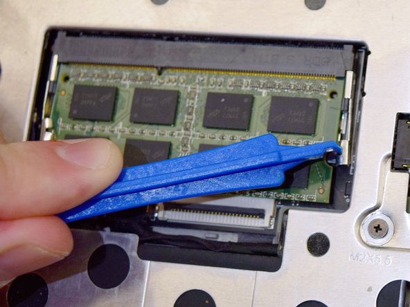

  5. IdeaPad Yoga 13 RAM Module Replacement, RAM Module: crwdns2935265:05crwdnd2935265:01crwdnd2935265:02crwdne2935265:0 IdeaPad Yoga 13 RAM Module Replacement, RAM Module: crwdns2935265:05crwdnd2935265:02crwdnd2935265:02crwdne2935265:0
    • Locate the RAM module.
    • Locate the retention clips holding the module in place, and gently push them outwards.
  6. IdeaPad Yoga 13 RAM Module Replacement: crwdns2935265:06crwdnd2935265:01crwdnd2935265:01crwdne2935265:0
    • The RAM module should pop up at an angle and can be lifted out.
    • When re-installing, insert the RAM module at the same angle, then push it down to re-engage the retention clips.
