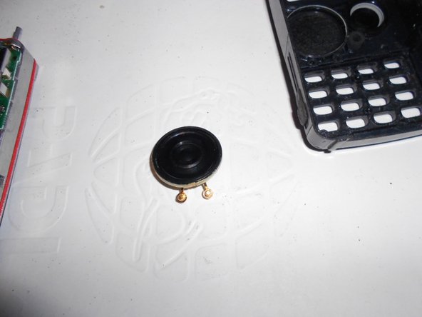

  5. Icom IC-T81A Speaker Replacement: crwdns2935265:05crwdnd2935265:01crwdnd2935265:02crwdne2935265:0 Icom IC-T81A Speaker Replacement: crwdns2935265:05crwdnd2935265:02crwdnd2935265:02crwdne2935265:0
    • Be very careful to avoid breaking the small leads connecting to the speaker.
    • With a needle nose, gently remove the gold plated contacts by pulling on the flange with an upward rocking motion.
    • Once the contacts are loose, grip the magnet on the back of the the speaker. A pair of good pliers may be helpful. Do not squeeze the speaker too forcefully.
    • The speaker is held in place with double-sided sticky tape. Use a slow rocking motion to pull free from the adhesive. Try not to damage this gasket.
    • Use this opportunity to clean any dust from the case, speaker grill and internals. The keyboard and power button will come out easily.
  6. Icom IC-T81A Speaker Replacement: crwdns2935265:06crwdnd2935265:01crwdnd2935265:01crwdne2935265:0
    • Use a combination of a brush, a vacuum and/or some compressed air and a cloth to clean the speaker cone. Make sure the metal fillings don't get into anything else on your work surface. Make sure no loose particles remain on the side that interfaces with the gasket.
    • When re-installing the speaker, align the contacts with their respective holes but don't press them in yet.
    • Place the speaker into its front panel location and press it in using a rocking downward pressure till seated. Gently apply pressure around the edges to ensure a good seal.
    • Use your needle nose to press the contacts into their respective holes.
