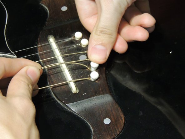

  3. Ibanez V300 Guitar Strings Replacement, Removing the Bridge Pin: crwdns2935265:03crwdnd2935265:01crwdnd2935265:01crwdne2935265:0
    • Using the all-in-one tool, slide the peg between the groove and gently lift up until the peg comes out.
  4. Ibanez V300 Guitar Strings Replacement, Aligning the String With the Bridge Pin: crwdns2935265:04crwdnd2935265:01crwdnd2935265:02crwdne2935265:0 Ibanez V300 Guitar Strings Replacement, Aligning the String With the Bridge Pin: crwdns2935265:04crwdnd2935265:02crwdnd2935265:02crwdne2935265:0
    • With your new string, align the nut end with the groove in the bridge pin so that the nut is at the opposite side of the head of the pin.
  5. Ibanez V300 Guitar Strings Replacement, Replacing the Bridge Pin: crwdns2935265:05crwdnd2935265:01crwdnd2935265:02crwdne2935265:0 Ibanez V300 Guitar Strings Replacement, Replacing the Bridge Pin: crwdns2935265:05crwdnd2935265:02crwdnd2935265:02crwdne2935265:0
    • Slide both the string and the bridge pin back into the hole,(make sure the groove is facing the string) and then when in place, apply a small amount of force with your thumb until you hear it click into place.
