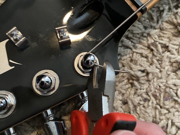

    • Turn the tuning pegs in a counterclockwise direction to loosen the strings.
    • Pull the strings from the tuning pegs and thread them out the back of the guitar.

  8. Ibanez Guitar Neck and Bridge Pickups Replacement: crwdns2935265:08crwdnd2935265:01crwdnd2935265:02crwdne2935265:0 Ibanez Guitar Neck and Bridge Pickups Replacement: crwdns2935265:08crwdnd2935265:02crwdnd2935265:02crwdne2935265:0
    • Thread your new strings through the back of the guitar, up to the tuning pegs, and tighten the strings.
    • Use the wire cutters to trim excess string from the ends.
