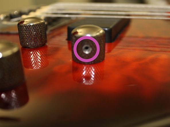

    • Turn the instrument over.
    • Locate the potentiometer knob.
    • Locate the allen screw socket on the knob.
  8. Ibanez 5 String Bass Model SR405QM Potentiometer Replacement: crwdns2935265:08crwdnd2935265:01crwdnd2935265:02crwdne2935265:0 Ibanez 5 String Bass Model SR405QM Potentiometer Replacement: crwdns2935265:08crwdnd2935265:02crwdnd2935265:02crwdne2935265:0

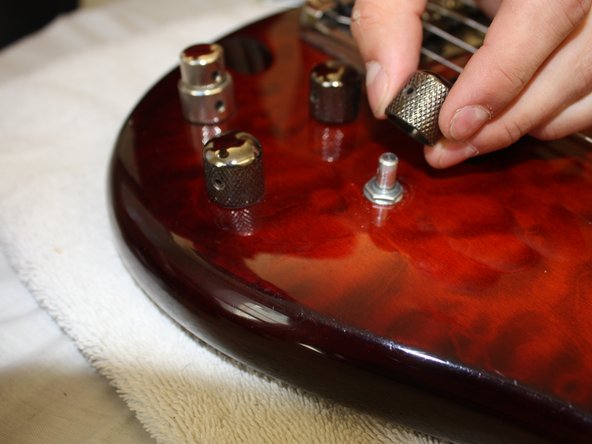

    • Use a 1/16" allen wrench to loosen the allen screw.
    • After the screw is loosened, lift the knob off of the instrument.

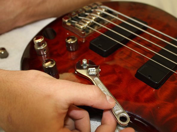

    • Locate the potentiometer nut, at the base of the potentiometer piston.
    • Use the adjustable wrench to remove the nut from the potentiometer.

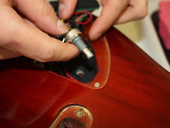

  10. Ibanez 5 String Bass Model SR405QM Potentiometer Replacement: crwdns2935265:010crwdnd2935265:01crwdnd2935265:02crwdne2935265:0 Ibanez 5 String Bass Model SR405QM Potentiometer Replacement: crwdns2935265:010crwdnd2935265:02crwdnd2935265:02crwdne2935265:0
    • Carefully turn the instrument over.
    • Remove the potentiometer from the instrument by gently pulling it upward.

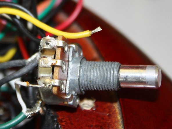

  11. Ibanez 5 String Bass Model SR405QM Potentiometer Replacement: crwdns2935265:011crwdnd2935265:01crwdnd2935265:03crwdne2935265:0 Ibanez 5 String Bass Model SR405QM Potentiometer Replacement: crwdns2935265:011crwdnd2935265:02crwdnd2935265:03crwdne2935265:0 Ibanez 5 String Bass Model SR405QM Potentiometer Replacement: crwdns2935265:011crwdnd2935265:03crwdnd2935265:03crwdne2935265:0

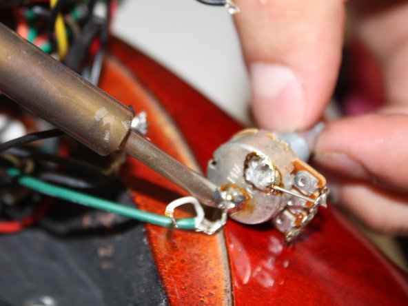

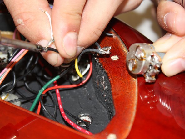

    • Use the soldering iron to release the black, yellow, and white wires from the side of the potentiometer.
    • The soldering iron is extremely hot. Avoid contact with skin, fabric or the body of the instrument. When soldering iron is not in use, rest it on the soldering iron stand.
  12. Ibanez 5 String Bass Model SR405QM Potentiometer Replacement: crwdns2935265:012crwdnd2935265:01crwdnd2935265:03crwdne2935265:0 Ibanez 5 String Bass Model SR405QM Potentiometer Replacement: crwdns2935265:012crwdnd2935265:02crwdnd2935265:03crwdne2935265:0 Ibanez 5 String Bass Model SR405QM Potentiometer Replacement: crwdns2935265:012crwdnd2935265:03crwdnd2935265:03crwdne2935265:0

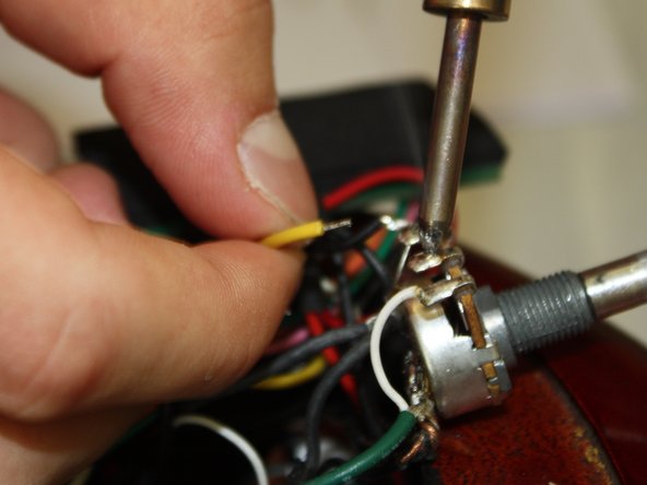

    • Use the soldering iron to release the black and green wires from the bottom of the potentiometer.
