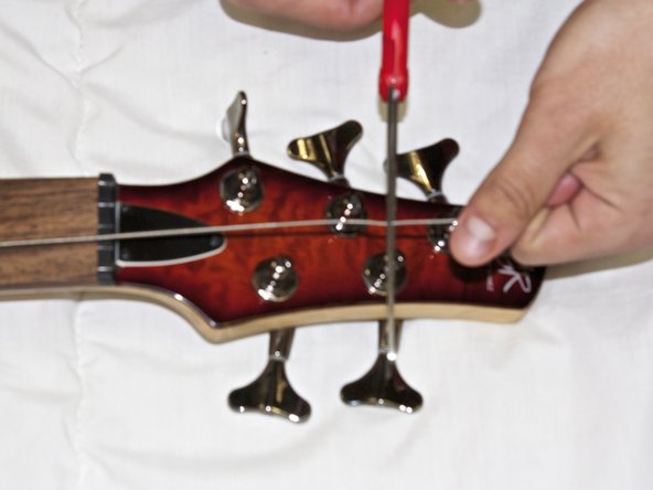

    • On a taut string, measure one inch past the nut before using a pair of wire cutters to cut the string.
  7. Ibanez 5 String Bass Model SR405QM Intonation Adjustment: crwdns2935265:07crwdnd2935265:01crwdnd2935265:01crwdne2935265:0

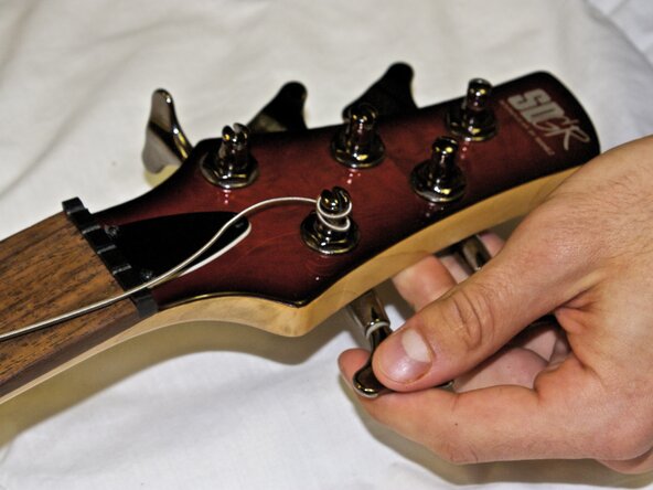

    • Take the end of the string and insert it into the hole in the middle of the string tree.
  8. Ibanez 5 String Bass Model SR405QM Intonation Adjustment: crwdns2935265:08crwdnd2935265:01crwdnd2935265:01crwdne2935265:0
    • Bend the string sideways into the channel of the string tree.
  9. Ibanez 5 String Bass Model SR405QM Intonation Adjustment: crwdns2935265:09crwdnd2935265:01crwdnd2935265:01crwdne2935265:0
    • Use one hand to maintain tension in the string by grabbing the string and rotating the hand toward the fret board.
    • If tension is not retained it may result in uneven tension in the string tree, causing the tree to break.

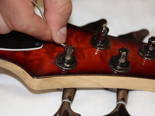

  10. Ibanez 5 String Bass Model SR405QM Intonation Adjustment: crwdns2935265:010crwdnd2935265:01crwdnd2935265:01crwdne2935265:0
    • Rotate the tuning peg counterclockwise until the string is slightly taut, but not tight.
    • Check to ensure that the string is lined up with the proper notch in the nut.
    • You will have proper alignment when the sting bends at a minimum angle.

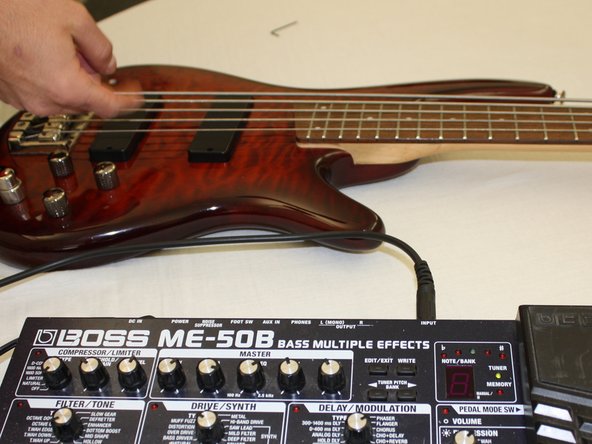

    • Plug the instrument cable into input jack.
    • Plug the other end of cable into the tuner.
  15. Ibanez 5 String Bass Model SR405QM Intonation Adjustment: crwdns2935265:015crwdnd2935265:01crwdnd2935265:01crwdne2935265:0
    • Tune strings following string replacement guide.
  16. Ibanez 5 String Bass Model SR405QM Intonation Adjustment: crwdns2935265:016crwdnd2935265:01crwdnd2935265:02crwdne2935265:0 Ibanez 5 String Bass Model SR405QM Intonation Adjustment: crwdns2935265:016crwdnd2935265:02crwdnd2935265:02crwdne2935265:0

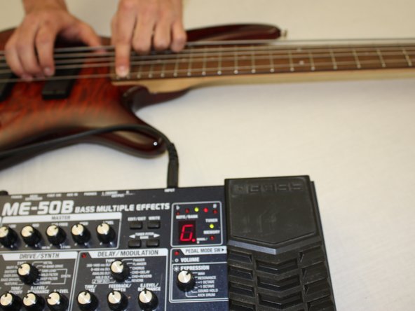

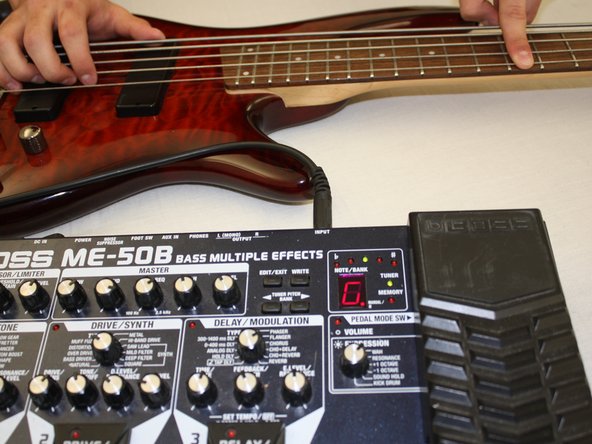

    • Check the intonation of each of your strings by playing the 12th fret and 24th fret.
    • In the pictures, we can see that on the G string the 12th is slightly flat (as the red light to the left of the green light is illuminated) and the 24th fret is slightly sharp (as the red light to the right of the green light is illuminated)
  17. Ibanez 5 String Bass Model SR405QM Intonation Adjustment: crwdns2935265:017crwdnd2935265:01crwdnd2935265:02crwdne2935265:0 Ibanez 5 String Bass Model SR405QM Intonation Adjustment: crwdns2935265:017crwdnd2935265:02crwdnd2935265:02crwdne2935265:0

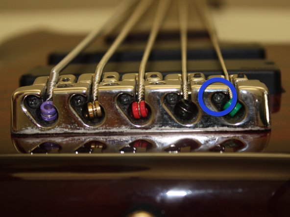

    • After determining which string you need to intonate, locate the corresponding bridge.
    • Note: In our demo we will change the intonation of the G string.
    • Locate the corresponding Phillips head screw we will use to change the position of the bridge.
  18. Ibanez 5 String Bass Model SR405QM Intonation Adjustment: crwdns2935265:018crwdnd2935265:01crwdnd2935265:01crwdne2935265:0
    • Our G string was slightly sharp at high notes, therefore we will unscrew the screw in order to make the string longer.
    • If the string is sharp at high notes, loosen the screw, making the string longer.If the string is flat at high notes, tighten the screw, making the string shorter.

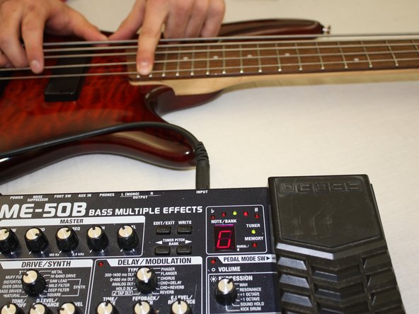

  19. Ibanez 5 String Bass Model SR405QM Intonation Adjustment: crwdns2935265:019crwdnd2935265:01crwdnd2935265:03crwdne2935265:0 Ibanez 5 String Bass Model SR405QM Intonation Adjustment: crwdns2935265:019crwdnd2935265:02crwdnd2935265:03crwdne2935265:0 Ibanez 5 String Bass Model SR405QM Intonation Adjustment: crwdns2935265:019crwdnd2935265:03crwdnd2935265:03crwdne2935265:0
    • Re-tune the string, and then recheck the pitch of the 12th and 24th fret. Note how only the green light is illuminated, indicating that the pitch is now a G.
    • If the 12th and 24th fret are not in tune, repeat step 5 until they are in tune.
    • If the 12th and 24th fret are in tune, repeat steps 3 through 5 for each of your strings until each string is intonated.
