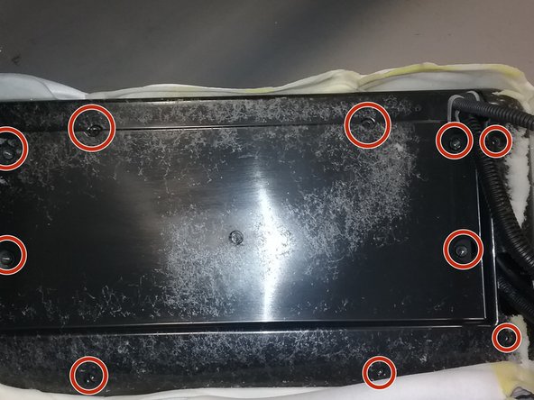

  4. IT-8800 Footrest Disassembly: crwdns2935265:04crwdnd2935265:01crwdnd2935265:02crwdne2935265:0 IT-8800 Footrest Disassembly: crwdns2935265:04crwdnd2935265:02crwdnd2935265:02crwdne2935265:0
    • Next step is to unzip the leather from the bottom piece. Once unzipped you should be left with this. From here, just carefully pull back the foam to reveal the back cover and screws. Remove the back cover by unscrewing the 12 screws. Unfortunately, due to photo size limitations I'm unable to show all 12.
