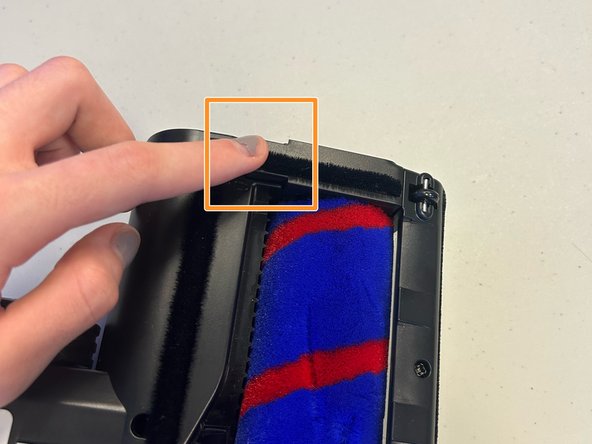

    • Unlock the side lock on the underside of the cleaner head by pulling it towards the unlock symbol.
    • While pressing down on the side lock with one hand, remove the side cover with the other.

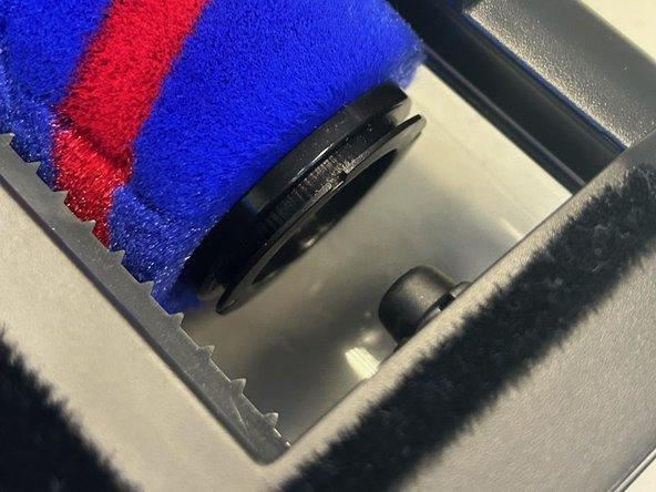

  2. INSE S6X Brush Roll Replacement: crwdns2935265:02crwdnd2935265:01crwdnd2935265:01crwdne2935265:0
    • Lift up and remove the old brush roll.
  3. INSE S6X Brush Roll Replacement: crwdns2935265:03crwdnd2935265:01crwdnd2935265:03crwdne2935265:0 INSE S6X Brush Roll Replacement: crwdns2935265:03crwdnd2935265:02crwdnd2935265:03crwdne2935265:0 INSE S6X Brush Roll Replacement: crwdns2935265:03crwdnd2935265:03crwdnd2935265:03crwdne2935265:0
    • Insert the replacement brush roll that was included with the purchase of the vacuum.
    • Make sure the ends of the brush roll match the inside of the cleaner head.
    • Insert the side cover piece by pressing down.
