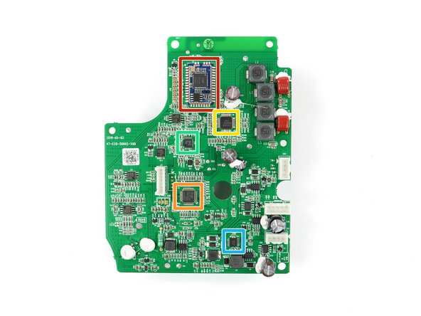

  3. IKEA Speaker Teardown: crwdns2935265:03crwdnd2935265:01crwdnd2935265:03crwdne2935265:0 IKEA Speaker Teardown: crwdns2935265:03crwdnd2935265:02crwdnd2935265:03crwdne2935265:0 IKEA Speaker Teardown: crwdns2935265:03crwdnd2935265:03crwdnd2935265:03crwdne2935265:0
    • The board in the top left provides the power. The board on the right carries the juicy stuff:
    • Bluetooth Module featuring the CSRA64110 Mono Audio Module with its antenna running along the top edge of the PCB.
    • The chip found in this video from "This Does Not Compute" in the 2018 model was a CSR64215 and in theory capable of aptX and stereo output—seems IKEA switched to the CSRA64110 in later models.
    • STM32F030 microcontroller featuring an Arm® Cortex®-M0
    • TAS5731M Stereo Digital Audio Power Amplifier from Texas Instruments
    • PCM1808 Stereo A/D Converter from Texas Instruments
    • Consonance Electronic CN3704 Standalone Li-ion Battery Charger

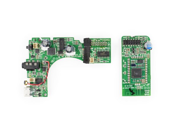

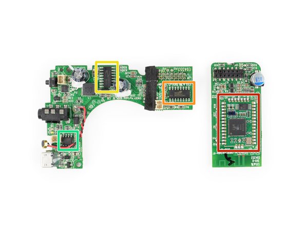

  5. IKEA Speaker Teardown: crwdns2935265:05crwdnd2935265:01crwdnd2935265:03crwdne2935265:0 IKEA Speaker Teardown: crwdns2935265:05crwdnd2935265:02crwdnd2935265:03crwdne2935265:0 IKEA Speaker Teardown: crwdns2935265:05crwdnd2935265:03crwdnd2935265:03crwdne2935265:0
    • Curled around the 2.5 Watt (6 Ohm) speaker we spot a small tube for some “bass reflex” action.
    • Unfortunately, the microUSB port, the power button, the line-in, and also the microphone are soldered onto the mainboard circumventing individual repairs. But we’re still happy for the user-replaceable battery option.
    • Inspecting the boards more closely we find that the main processor sits on a small breakout board. The Chips on both boards are as follows:
    • Bluetooth module with the CSR8645 dual-mode ROM audio SoC and its antenna running along the bottom.
    • This SoC supports voice processing technology and aptX codec technology.
    • HOLTEK HT46R004 A/D 8-Bit MCU (microcontroller unit)
    • CHIPSTAR CS8323S Audio Amplifier
    • Consonance Electronic CN3085 Nickel-Metal Hydride Battery Charger IC

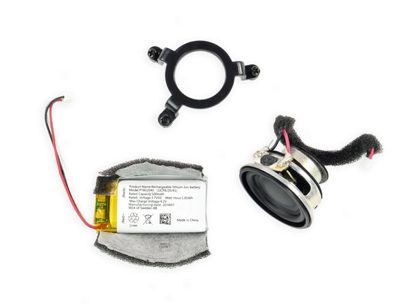

  7. IKEA Speaker Teardown: crwdns2935265:07crwdnd2935265:01crwdnd2935265:02crwdne2935265:0 IKEA Speaker Teardown: crwdns2935265:07crwdnd2935265:02crwdnd2935265:02crwdne2935265:0
    • The Lithium-Ion battery can be charged through the microUSB port on the top and provides 1.58 Wh (500 mAh @ 4.2 V, model PT802040).
    • It is connected to the mainboard with a JST plug meaning it can (in theory) be replaced when it has degraded after a few years—no soldering required, yay.
    • This little 4 Ohm 2.5 Watt driver seems to have a lot of "oomph" for its size compared to the Eneby Portable.
    • If you want to know more about the audio quality of this little guy you might want to head over to soundguys.com.

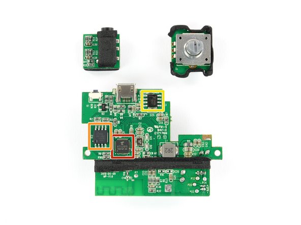

  8. IKEA Speaker Teardown: crwdns2935265:08crwdnd2935265:01crwdnd2935265:02crwdne2935265:0 IKEA Speaker Teardown: crwdns2935265:08crwdnd2935265:02crwdnd2935265:02crwdne2935265:0
    • The volume encoder and line-in jack can be removed separately. Unfortunately, the microUSB port and the power button are soldered to the mainboard. This leaves us with a happy and a sad eye.
    • These are the chips we find on the board:
    • Actions Technology ATS2819 Single-Chip Bluetooth Audio Solution
    • cFeon Q80B-104HIP
    • TP4056 Li-Ion Battery Charger IC
    • On this board you can see the antenna in the bottom left corner.

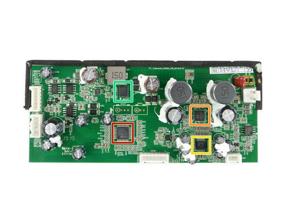

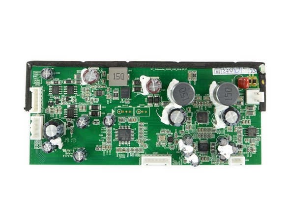

  11. IKEA Speaker Teardown: crwdns2935265:011crwdnd2935265:01crwdnd2935265:03crwdne2935265:0 IKEA Speaker Teardown: crwdns2935265:011crwdnd2935265:02crwdnd2935265:03crwdne2935265:0 IKEA Speaker Teardown: crwdns2935265:011crwdnd2935265:03crwdnd2935265:03crwdne2935265:0
    • The subwoofer runs on these silicons:
    • STM32F 32-Bit microcontroller
    • NTP7513 audio amplifier by N CITRON (formerly NEOFIDELITY).
    • CSD16322 Power MOSFET from Texas Instruments
    • On the rear there is the same CN3704 Standalone Li-ion Battery Charger we found on the ENEBY 8".

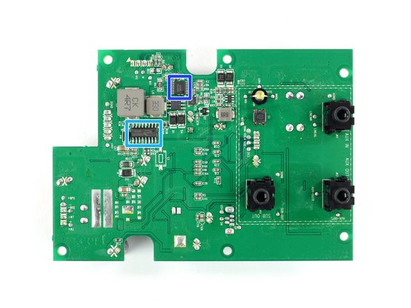

  13. IKEA Speaker Teardown: crwdns2935265:013crwdnd2935265:01crwdnd2935265:03crwdne2935265:0 IKEA Speaker Teardown: crwdns2935265:013crwdnd2935265:02crwdnd2935265:03crwdne2935265:0 IKEA Speaker Teardown: crwdns2935265:013crwdnd2935265:03crwdnd2935265:03crwdne2935265:0
    • Besides some neat symbols for where the screws go the mainboard carries these chips:
    • ATS2825 Bluetooth Audio Solution from Actions Technology
    • AH1834 IC
    • The two 72015 S0180 JRC are most likely audio amplifiers from the company New Japan Radio.
    • On the rear side of the board we find three line-in jacks labelled "AUX IN", AUX OUT" and SUB OUT", a button, an LED, and some additional chips:
    • CHIPSTAR CS5026E Audio Amplifier
    • And again the CN3704 Standalone Li-ion Battery Charger
