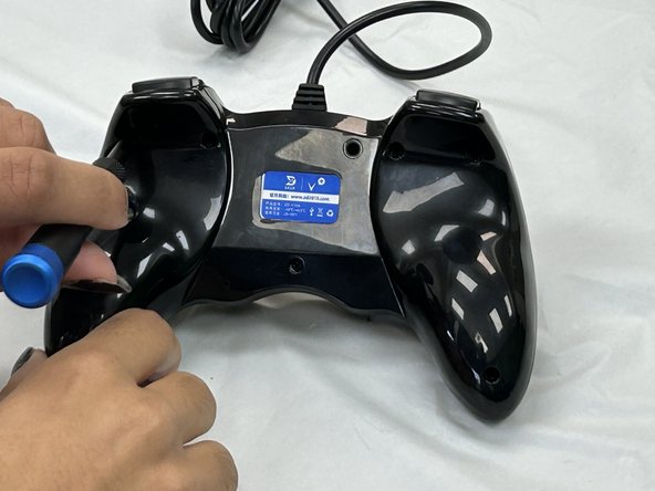

    • Remove the seven 9.2 mm screws from the back of the controller using a Phillips #00 screwdriver.
    • Remove the back cover.

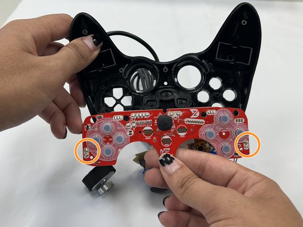

    • Remove the two 7.2 mm screws that connect the red daughterboard to the tan motherboard using a Phillips #00 screwdriver.

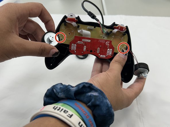

    • Pull off the glue holding the wires down on both sides of the controller.
    • Pull the vibration motors out of their plastic frames and hold them or set the controller down so as to not strain the wires.

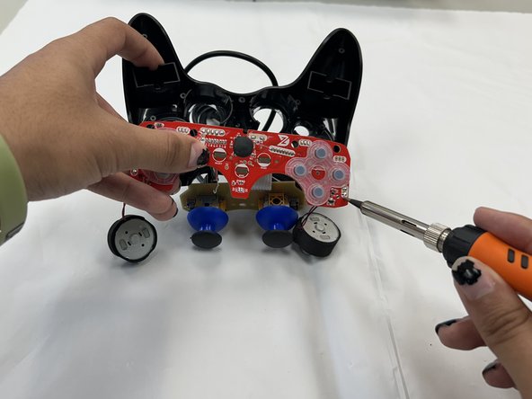

    • Carefully pull up on the motherboard until it slides off from the four black cylinders keeping it in place.
    • Flip the motherboard to its other side and locate the pieces of metal that are connected to the red and black wires.

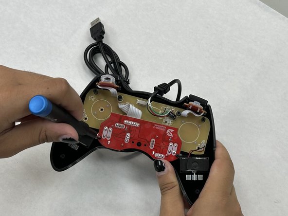

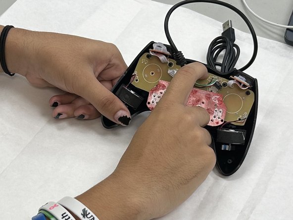

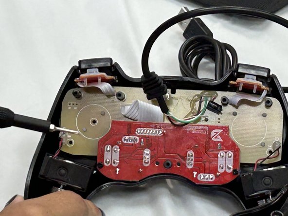

    • Use a soldering iron and this soldering guide to desolder both vibration motors’ wires from the motherboard.
