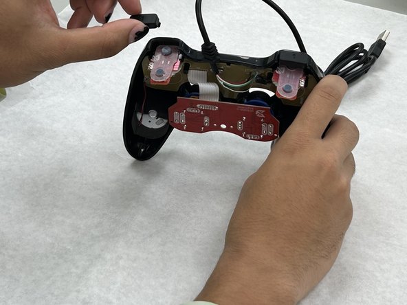

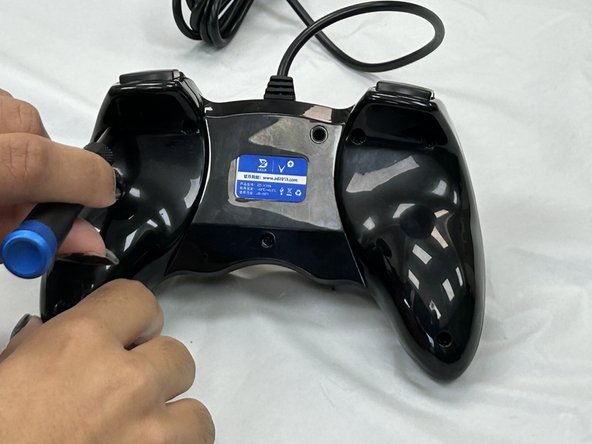

    • Remove the seven 9.2 mm screws from the back of the controller using a Phillips #00 screwdriver.
    • Remove the back cover.

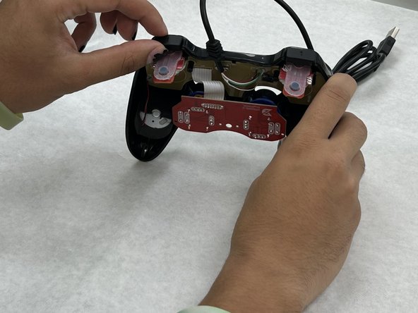

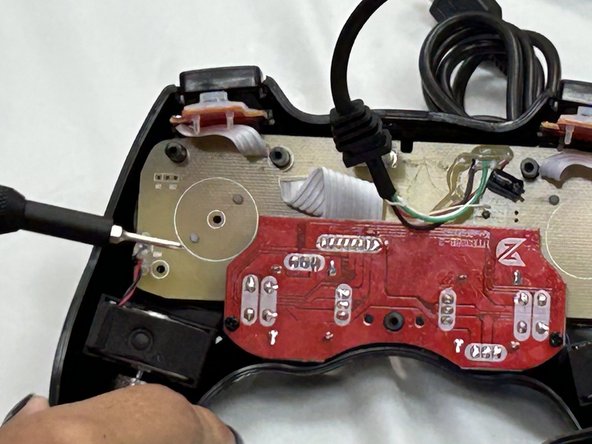

  2. IFYOO ZD-V108 Shoulder Button Cover Replacement: crwdns2935265:02crwdnd2935265:01crwdnd2935265:03crwdne2935265:0 IFYOO ZD-V108 Shoulder Button Cover Replacement: crwdns2935265:02crwdnd2935265:02crwdnd2935265:03crwdne2935265:0 IFYOO ZD-V108 Shoulder Button Cover Replacement: crwdns2935265:02crwdnd2935265:03crwdnd2935265:03crwdne2935265:0
    • Pull the two shoulder button covers towards yourself carefully.
    • The buttons are fragile and can break if there is upwards pressure on the hooks of the shoulder buttons.
