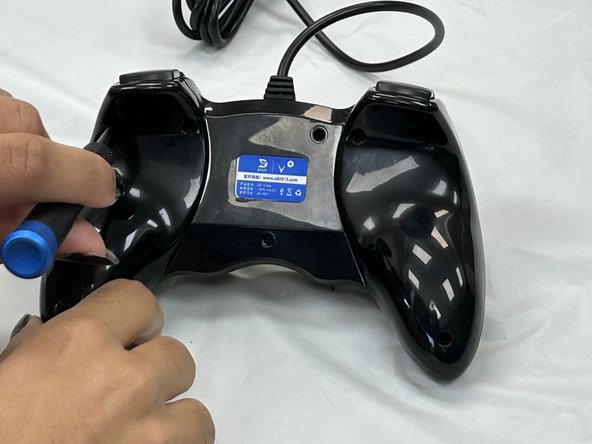

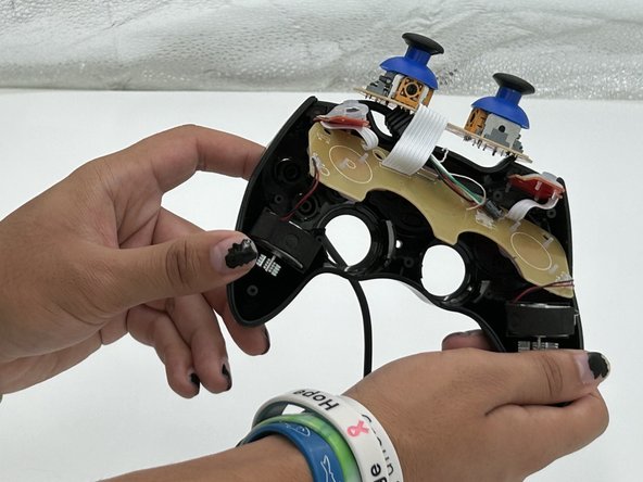

    • Remove the seven 9.2 mm screws from the back of the controller using a Phillips #00 screwdriver.
    • Remove the back cover.

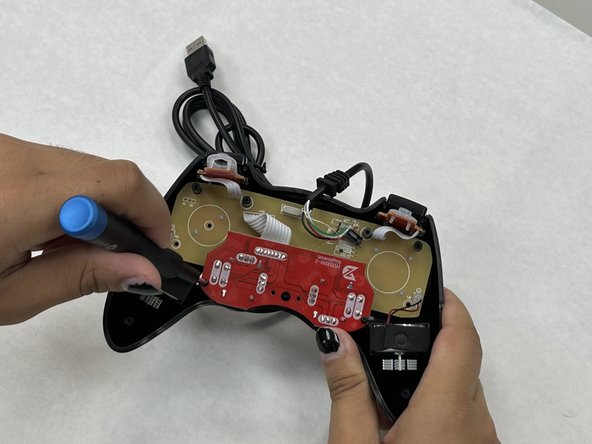

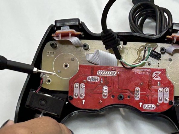

  2. IFYOO ZD-V108 Face Buttons Replacement: crwdns2935265:02crwdnd2935265:01crwdnd2935265:02crwdne2935265:0 IFYOO ZD-V108 Face Buttons Replacement: crwdns2935265:02crwdnd2935265:02crwdnd2935265:02crwdne2935265:0
    • Remove the two 7.2 mm screws that connect the red daughterboard to the tan motherboard using a Phillips #00 screwdriver.

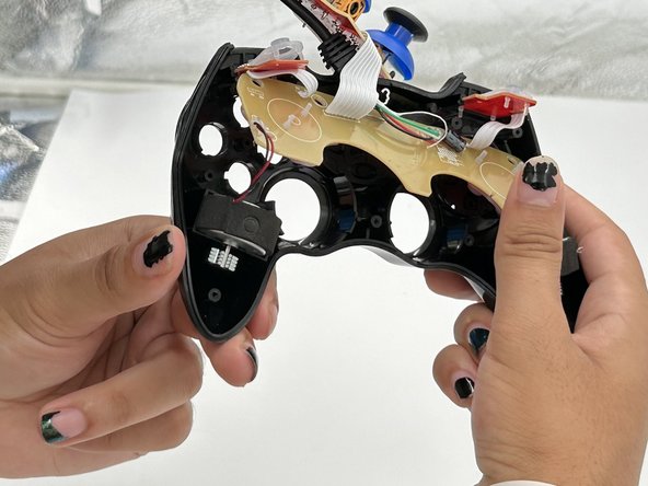

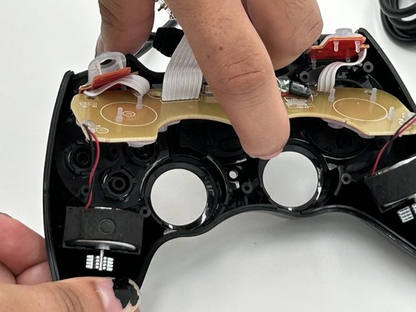

  3. IFYOO ZD-V108 Face Buttons Replacement: crwdns2935265:03crwdnd2935265:01crwdnd2935265:03crwdne2935265:0 IFYOO ZD-V108 Face Buttons Replacement: crwdns2935265:03crwdnd2935265:02crwdnd2935265:03crwdne2935265:0 IFYOO ZD-V108 Face Buttons Replacement: crwdns2935265:03crwdnd2935265:03crwdnd2935265:03crwdne2935265:0
    • Carefully pull up on the motherboard until it slides off from the four black cylinders keeping it in place.

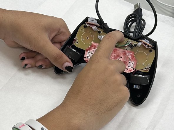

  4. IFYOO ZD-V108 Face Buttons Replacement: crwdns2935265:04crwdnd2935265:01crwdnd2935265:03crwdne2935265:0 IFYOO ZD-V108 Face Buttons Replacement: crwdns2935265:04crwdnd2935265:02crwdnd2935265:03crwdne2935265:0 IFYOO ZD-V108 Face Buttons Replacement: crwdns2935265:04crwdnd2935265:03crwdnd2935265:03crwdne2935265:0
    • Push out the face buttons located on the left side of the controller.
