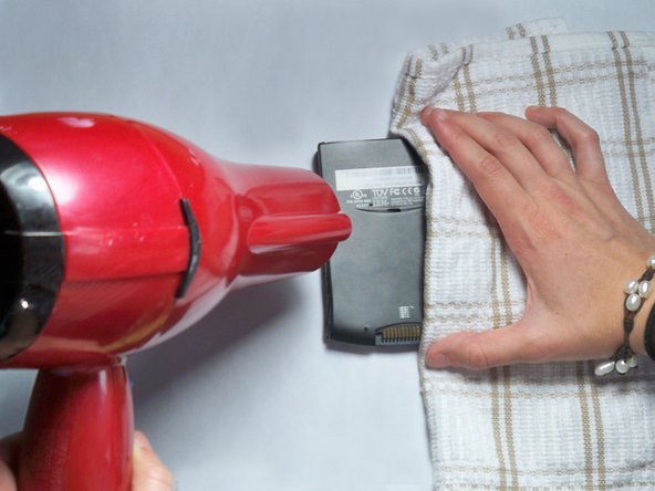

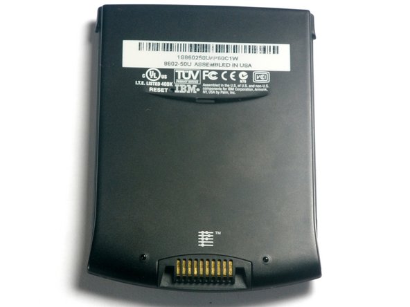

      • Turn the device over so that the screen is facing down.
      • In the next step the device will be heated, so the screen must be turned over to prevent heat damage to the LCD/Digitizer.
    2. IBM WorkPad c3 Motherboard Replacement: crwdns2935265:02crwdnd2935265:01crwdnd2935265:01crwdne2935265:0
      • Using a hair dryer, slowly heat the edges of the WorkPad.
      • Spend at least one minute heating each side of the device. This will melt the glue holding the case together, and allow it to be removed.
      • Be sure not to touch the device directly after heating as it will be extremely hot. Use a towel or oven mitt to grab it.

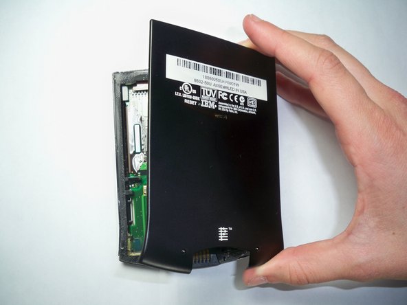

    3. IBM WorkPad c3 Motherboard Replacement: crwdns2935265:03crwdnd2935265:01crwdnd2935265:02crwdne2935265:0 IBM WorkPad c3 Motherboard Replacement: crwdns2935265:03crwdnd2935265:02crwdnd2935265:02crwdne2935265:0
      • Use a plastic opening tool to pry the back case from the WorkPad.
      • If the rear cover is not coming off very easily, you probably need to reheat the case in order to sufficiently melt the glue.

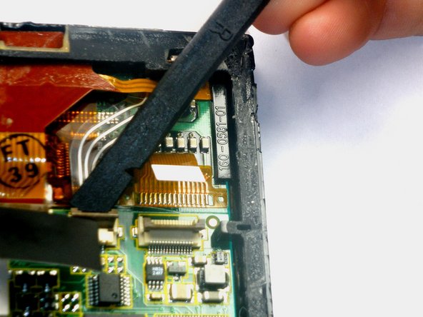

    1. IBM WorkPad c3 Motherboard Replacement, LCD: crwdns2935265:010crwdnd2935265:01crwdnd2935265:02crwdne2935265:0 IBM WorkPad c3 Motherboard Replacement, LCD: crwdns2935265:010crwdnd2935265:02crwdnd2935265:02crwdne2935265:0
      • Using the spudger lift the tabs holding the LCD/Digitizer combo cables to the WorkPad.

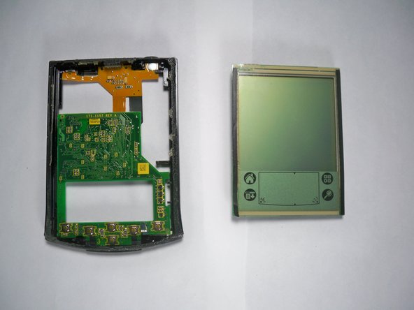

    2. IBM WorkPad c3 Motherboard Replacement: crwdns2935265:011crwdnd2935265:01crwdnd2935265:02crwdne2935265:0 IBM WorkPad c3 Motherboard Replacement: crwdns2935265:011crwdnd2935265:02crwdnd2935265:02crwdne2935265:0
      • Using your thumb, press down gently on the back of the LCD.
      • The LCD will disconnect and fall out of the case, so be sure to have your hand waiting for it.

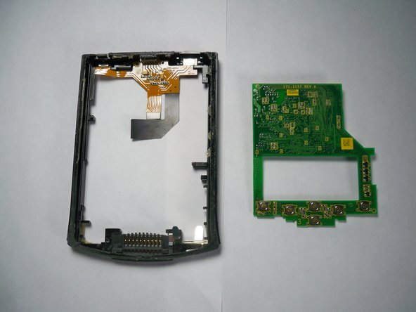

    1. IBM WorkPad c3 Motherboard Replacement, Motherboard: crwdns2935265:012crwdnd2935265:01crwdnd2935265:01crwdne2935265:0
      • Using the plastic opening tool, lift the clip holding the motherboard cable.
    2. IBM WorkPad c3 Motherboard Replacement: crwdns2935265:013crwdnd2935265:01crwdnd2935265:02crwdne2935265:0 IBM WorkPad c3 Motherboard Replacement: crwdns2935265:013crwdnd2935265:02crwdnd2935265:02crwdne2935265:0
      • Gripping the motherboard as shown, lift up slightly and pull outward.
      • Small plastic tabs hold the motherboard down. Lifting too hard will break these off, and the motherboard will be loose upon replacement.
