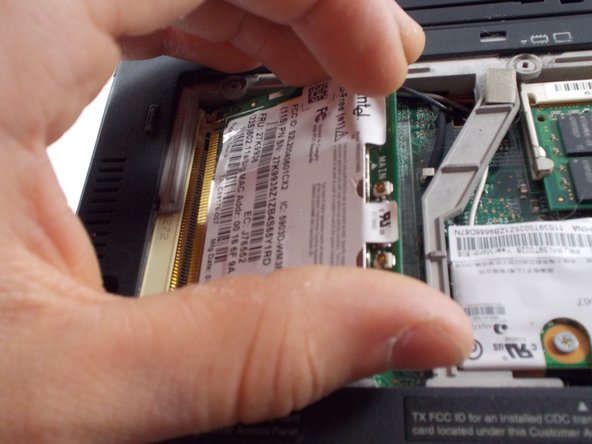

    • Flip the laptop over and remove the battery
    • Remove all highlighted screws with a Phillips head screwdriver
  2. IBM Thinkpad x41t Laptop Wifi Card Replacement: crwdns2935265:02crwdnd2935265:01crwdnd2935265:02crwdne2935265:0 IBM Thinkpad x41t Laptop Wifi Card Replacement: crwdns2935265:02crwdnd2935265:02crwdnd2935265:02crwdne2935265:0
    • Gently unconnect the grey and black wires
  3. IBM Thinkpad x41t Laptop Wifi Card Replacement: crwdns2935265:03crwdnd2935265:01crwdnd2935265:02crwdne2935265:0 IBM Thinkpad x41t Laptop Wifi Card Replacement: crwdns2935265:03crwdnd2935265:02crwdnd2935265:02crwdne2935265:0
    • Lift the wireless card and pull it out of the motherboard
    • Replace the wifi card and retrace your steps to reassemble the laptop
