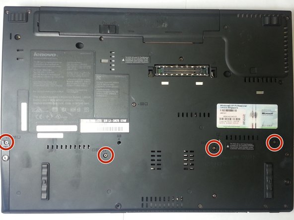

    • Flip your computer over and remove the four indicated screws with the Phillips #1 screwdriver.

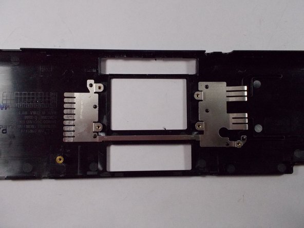

    • With the screws removed, the trackpad panel should lift as shown. Gently lift so the inside is visible.

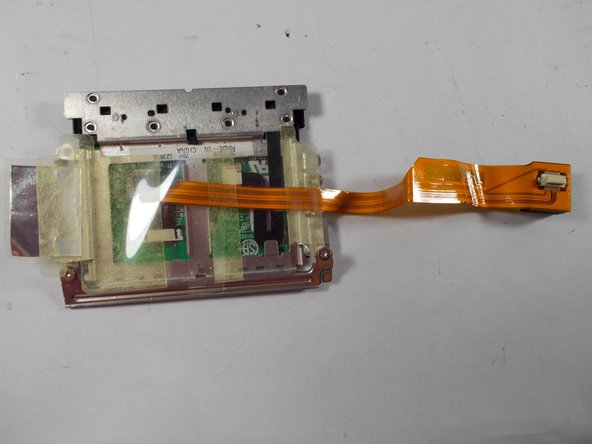

    • Gently remove the white plug to disconnect the trackpad panel from the bottom of the computer.
    • Use the screwdriver to remove the four screws from the trackpad. Two of the screws are located just under the plastic.
  4. IBM Thinkpad T61 Trackpad Replacement: crwdns2935265:04crwdnd2935265:01crwdnd2935265:03crwdne2935265:0 IBM Thinkpad T61 Trackpad Replacement: crwdns2935265:04crwdnd2935265:02crwdnd2935265:03crwdne2935265:0 IBM Thinkpad T61 Trackpad Replacement: crwdns2935265:04crwdnd2935265:03crwdnd2935265:03crwdne2935265:0
    • Separate the trackpad with the bottom mouse buttons from the trackpad panel.

    • Align the new trackpad so the screw holes line up with their insertion points. Replace the screws with the screwdriver.
