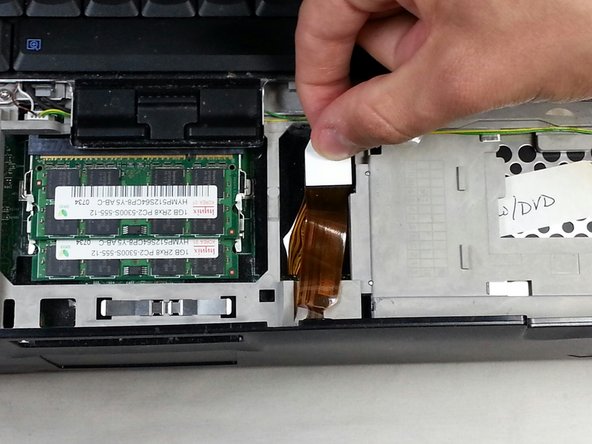

  7. IBM Thinkpad T61 Keyboard Replacement: crwdns2935265:07crwdnd2935265:01crwdnd2935265:02crwdne2935265:0 IBM Thinkpad T61 Keyboard Replacement: crwdns2935265:07crwdnd2935265:02crwdnd2935265:02crwdne2935265:0
    • Gently pull the panel away from the computer.
    • BE CAREFUL! The panel is still attached by the touchpad's data cable.
    • Detach the connecter by pulling up on the white tab.
  8. IBM Thinkpad T61 Keyboard Replacement: crwdns2935265:08crwdnd2935265:01crwdnd2935265:02crwdne2935265:0 IBM Thinkpad T61 Keyboard Replacement: crwdns2935265:08crwdnd2935265:02crwdnd2935265:02crwdne2935265:0
