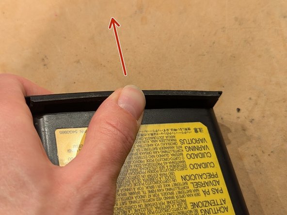

    • Remove the locking battery front faceplate by pushing it from the middle away from the battery pack until it bends a few mm.
    • While still applying forward pressure, slide the faceplate up and away from the battery.

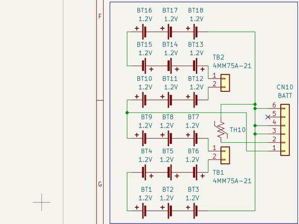

    • The cover lifts off, exposing the eighteen 3/4A NiMH cells inside.
    • The device on top, with the black and white wires, is a thermistor for sensing the temperature of the pack.
    • There are two safety devices (not shown) which connect in series with each of the two series strings of cells. They are Klixon 4MM75A-21 overcurrent/overtemperature protection devices which use a bimetallic strip to break the circuit.
