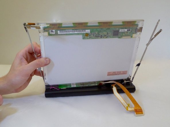

    11. IBM ThinkPad X41 LCD Screen Replacement: crwdns2935265:011crwdnd2935265:01crwdnd2935265:02crwdne2935265:0 IBM ThinkPad X41 LCD Screen Replacement: crwdns2935265:011crwdnd2935265:02crwdnd2935265:02crwdne2935265:0
      • Using a Phillips Screwdriver (Size PH001), remove the screws from the LCD screen support arms.
    12. IBM ThinkPad X41 LCD Screen Replacement: crwdns2935265:012crwdnd2935265:01crwdnd2935265:02crwdne2935265:0 IBM ThinkPad X41 LCD Screen Replacement: crwdns2935265:012crwdnd2935265:02crwdnd2935265:02crwdne2935265:0
      • Unplug the orange LCD screen cable from the small circuit board near the laptop keyboard.
    13. IBM ThinkPad X41 LCD Screen Replacement: crwdns2935265:013crwdnd2935265:01crwdnd2935265:02crwdne2935265:0 IBM ThinkPad X41 LCD Screen Replacement: crwdns2935265:013crwdnd2935265:02crwdnd2935265:02crwdne2935265:0
      • Using one hand, gently lift the LCD screen out of support arms.
