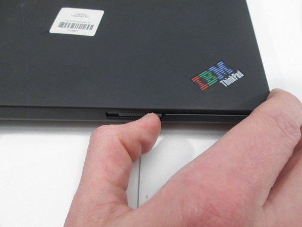

    • Turn laptop over, make sure lid side is faced down.
  2. IBM ThinkPad X41 Fan and Heat Sink Replacement: crwdns2935265:02crwdnd2935265:01crwdnd2935265:01crwdne2935265:0

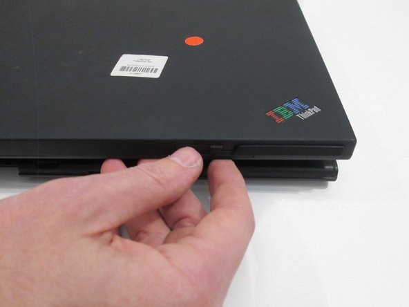

    • Locate battery release button lock on laptop, and press down.
  3. IBM ThinkPad X41 Fan and Heat Sink Replacement: crwdns2935265:03crwdnd2935265:01crwdnd2935265:01crwdne2935265:0
    • Hold laptop battery release button and gently pull battery away from laptop.
  4. IBM ThinkPad X41 Fan and Heat Sink Replacement, Keyboard: crwdns2935265:04crwdnd2935265:01crwdnd2935265:03crwdne2935265:0 IBM ThinkPad X41 Fan and Heat Sink Replacement, Keyboard: crwdns2935265:04crwdnd2935265:02crwdnd2935265:03crwdne2935265:0 IBM ThinkPad X41 Fan and Heat Sink Replacement, Keyboard: crwdns2935265:04crwdnd2935265:03crwdnd2935265:03crwdne2935265:0
    • Slide outward to unlock and lift battery up to remove.
    • Remove battery before keyboard to avoid damage to battery.

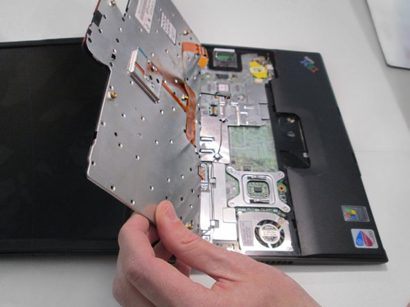

    • Flip the laptop over once more returning it to its upright position and open laptop .
  7. IBM ThinkPad X41 Fan and Heat Sink Replacement: crwdns2935265:07crwdnd2935265:01crwdnd2935265:02crwdne2935265:0 IBM ThinkPad X41 Fan and Heat Sink Replacement: crwdns2935265:07crwdnd2935265:02crwdnd2935265:02crwdne2935265:0
    • Using your left hand, place thumb on the upper part of the keyboard and place your other thumb on the bottom part of the keyboard.
    • Push firmly upward with both thumbs. This will detach keyboard from base.
    • Be cautious when lifting as there is an orange connection cable still attached to the bottom side.
  8. IBM ThinkPad X41 Fan and Heat Sink Replacement: crwdns2935265:08crwdnd2935265:01crwdnd2935265:02crwdne2935265:0 IBM ThinkPad X41 Fan and Heat Sink Replacement: crwdns2935265:08crwdnd2935265:02crwdnd2935265:02crwdne2935265:0
    • Detach the connection to the motherboard by first sliding it towards you, then pulling upward away from your body.
    • This step's directions are based on the angle shown .
  9. IBM ThinkPad X41 Fan and Heat Sink Replacement: crwdns2935265:09crwdnd2935265:01crwdnd2935265:01crwdne2935265:0
    • Lift the entire keyboard off the laptop.

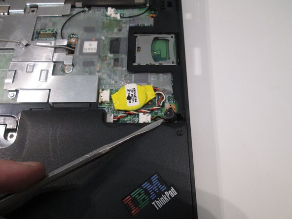

    • At the top right of the laptop remove the white tab connected to the motherboard by pulling it to the right.
    • The regular black nylon spudger should be used whenever possible, especially around sensitive internal components.
    • The display was already removed from another guide.

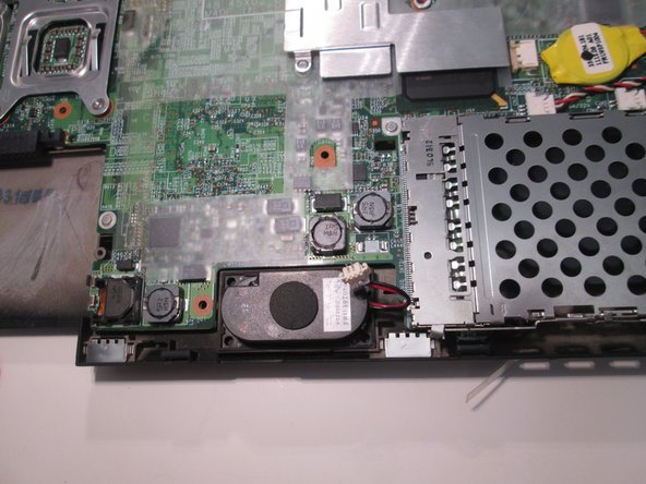

    • Remove the white tab at the bottom connected to the speaker by sliding it to the right.

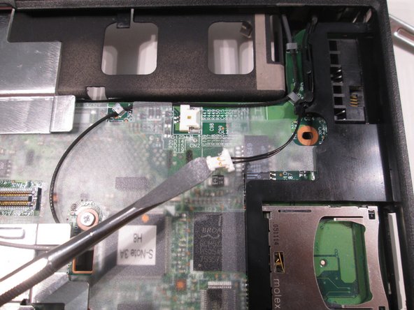

    • Remove the display connection by pulling it up.

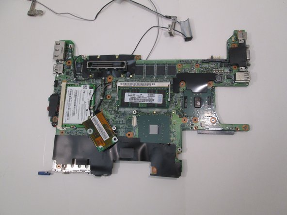

  21. IBM ThinkPad X41 Fan and Heat Sink Replacement: crwdns2935265:021crwdnd2935265:01crwdnd2935265:01crwdne2935265:0
    • The motherboard can then be removed by pulling it up from the left side.
  22. IBM ThinkPad X41 Fan and Heat Sink Replacement: crwdns2935265:022crwdnd2935265:01crwdnd2935265:01crwdne2935265:0
    • Flip the motherboard over.
    • Remove the indicated 5mm and 4mm screws with a phillips head screwdriver.

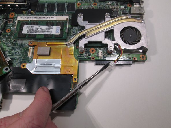

    • Remove the white tab below the fan by pulling it to the right.
  25. IBM ThinkPad X41 Fan and Heat Sink Replacement: crwdns2935265:025crwdnd2935265:01crwdnd2935265:01crwdne2935265:0
    • Holding the fan move the whole assembly to the left past the notch holding it in.
  26. IBM ThinkPad X41 Fan and Heat Sink Replacement: crwdns2935265:026crwdnd2935265:01crwdnd2935265:02crwdne2935265:0 IBM ThinkPad X41 Fan and Heat Sink Replacement: crwdns2935265:026crwdnd2935265:02crwdnd2935265:02crwdne2935265:0
    • The assembly is no longer attached and can be removed by pulling it out.
